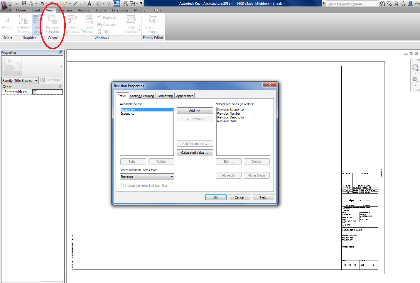

have you correctly set up a revision schedule inside of your titleblock family?

Of course, man. I'm talking about Revision "cloud" schedule, not just the regular revision schedule.
What I want is a schedule list what each "revision cloud" is regarded to, not just the simple revision description
