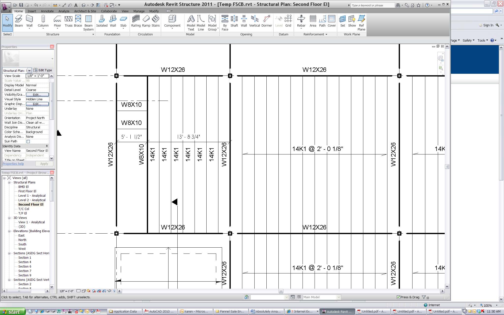

Why did this do this, and how do I make them look alike:Click image for larger version
Name:	plan joist.jpg
ID:	83077I would like to have the beam tag with the line and arrows not individually called out - how do I change this?

Mon, Nov 14, 2011 at 11:54:08 AM | Beam System Displaying Tags
seniorcad143
Joined: Fri, Oct 2, 2009
140 Posts
1 Stars: 1 Votes
Oh also - how do I get the two W8x10 lines to show as heavy a lineweight as the other beams?  And stop short of the other beams they are framing into?

Mon, Nov 14, 2011 at 12:24:58 PM | Beam System Displaying Tags
TKennedy
Joined: Wed, Oct 7, 2009
654 Posts
4 Stars: 8 Votes
IIRC, you need a beam system if you want a span tag instead of individual tags. Other things you can try is creating a new symbol, or use a dimension and override the text to say what you want.
For the graphics, check Object Styles and the Structural Usage for the beams.

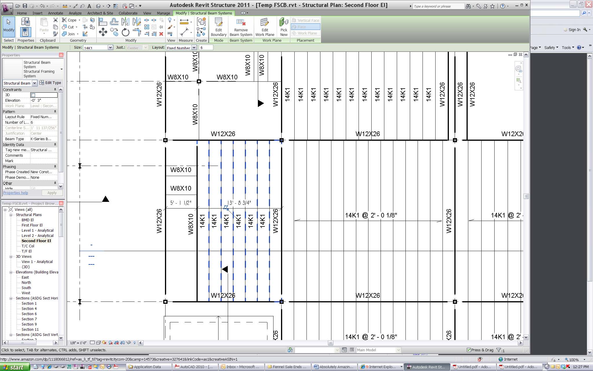

Mon, Nov 14, 2011 at 12:29:26 PM | Beam System Displaying Tags
seniorcad143
140 Posts
1 Stars: 1 Votes
It is a beam system - see below.

Mon, Nov 14, 2011 at 12:48:01 PM | Beam System Displaying Tags
seniorcad143
140 Posts
1 Stars: 1 Votes
You know it seems to do it when I use skecth to put in the beam system - how do I change this?

Mon, Nov 14, 2011 at 4:21:57 PM | Beam System Displaying Tags
dgcad
dgcad Avatar
Joined: Thu, Mar 17, 2005
1231 Posts
3.5 Stars: 36 Votes
When you 'Sketch' the beam system it puts in individual tags. Delete them. Then click on one of the string tags that you like, click the 'create similar' button, click to select the 'sketched beam system' and click to place the good tag.
Tue, Nov 15, 2011 at 7:33:08 AM | Beam System Displaying Tags
seniorcad143
140 Posts
1 Stars: 1 Votes
Thanks - that did it!!!
