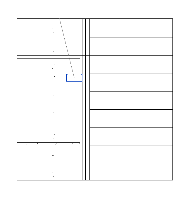

We have a 4 building, multi-family project.
The files are linked into a MasterSite file.
The CENTER OF ROTATION symbol has gone missing but only in the MasterSite file. All other projects work fine. This happens on all workstations. Appears to be a project issue vs computer, installation, network type issue.
Anyone else experiencing this?
REVIT 2012 / update release 2
Mon, Nov 14, 2011 at 9:36:49 AM | Center of rotation symbol is missing
Missing?  ... or you just don't see it?  This sound like the center is way off in space because of the size of your view.
Mon, Nov 14, 2011 at 10:59:18 AM | Center of rotation symbol is missing
rqtecht
Joined: Sun, Feb 24, 2008
9 Posts
Interesting thought. See attached screen capture. Looks like the center should be where the rotate line starts which is right in the middle of the object.
This happens on detail components as well as view tags like elevation symbols.
Mon, Nov 14, 2011 at 11:08:57 AM | Center of rotation symbol is missing
Might be a corrupted file since you say it in just that one file.
BTW - Do you ever clean up your errors?  Not saying that is the problem but it is good practice.  Mange tab - warnings.
Mon, Nov 14, 2011 at 11:21:52 AM | Center of rotation symbol is missing
rqtecht
9 Posts
We are working on the warnings but there are a few.
We audit, purge, compact and archive regularly.
Corrupt file - any fix?
