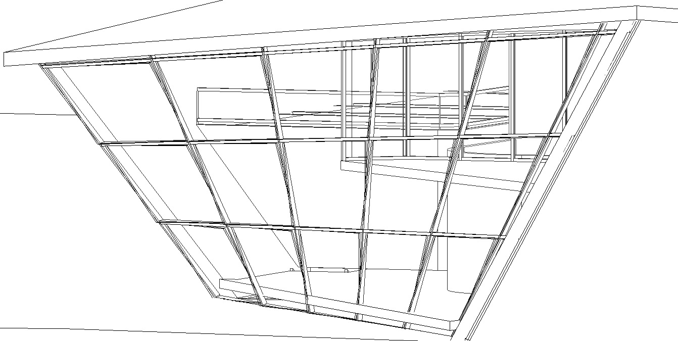

Hi Everyone,
I have been trying to figure out how to fix the complex curved curtain wall I made. This is originally a mass I created, which I then loaded into my project, made walls, and when I try to make a curtain wall, it's really distorted. I am assuming because it curves really werid, it can't make it properly.
I tried dividing the surface in the original mass file, and then applying a pattern (rectangle) and then it just overlaps really weird :S It doesn't actually make a pattern.
Is there any way to make this actually work??
Thanks in advance.

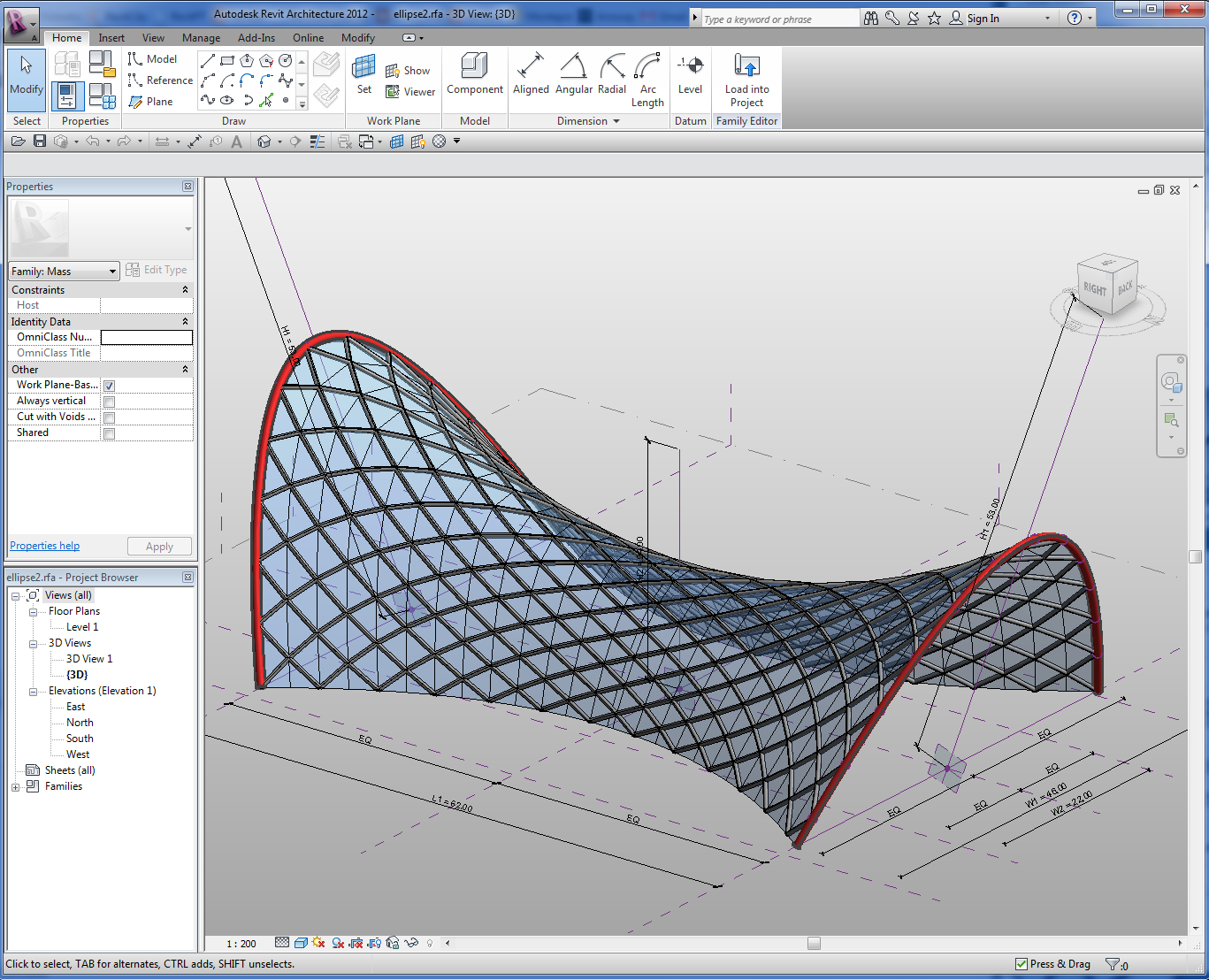

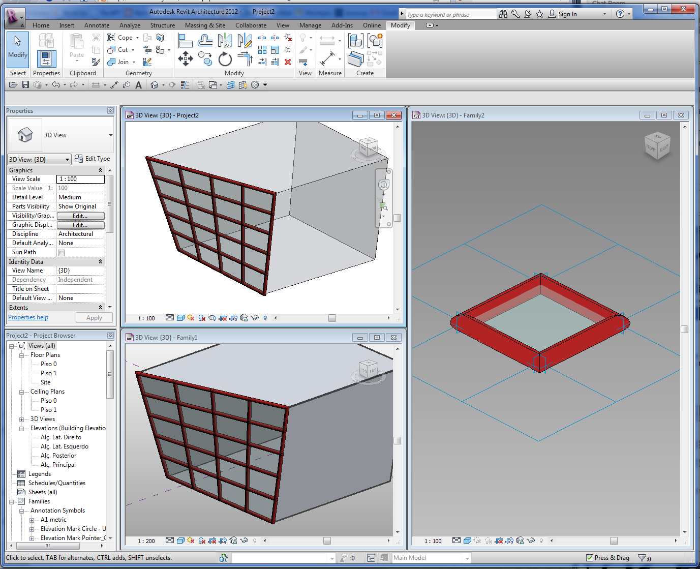

You can create that with the "Conceptual Mass" and with a "Curtain Panel Pattern Based" family.

Thanks for your help! I simplified and essentially figured out the pattern based family.
