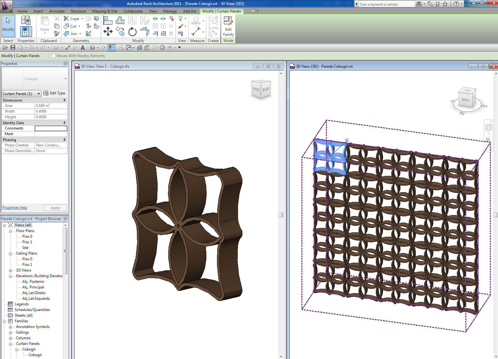

Any suggestions on how to create a brick screen wall?

I created this one with "curtain walls" BUT if you have a good "TEXTURE" with 2 images, one to the "BUMP" and the second to the "CUT-OUTS" you can have the same result.
Hope this Help
