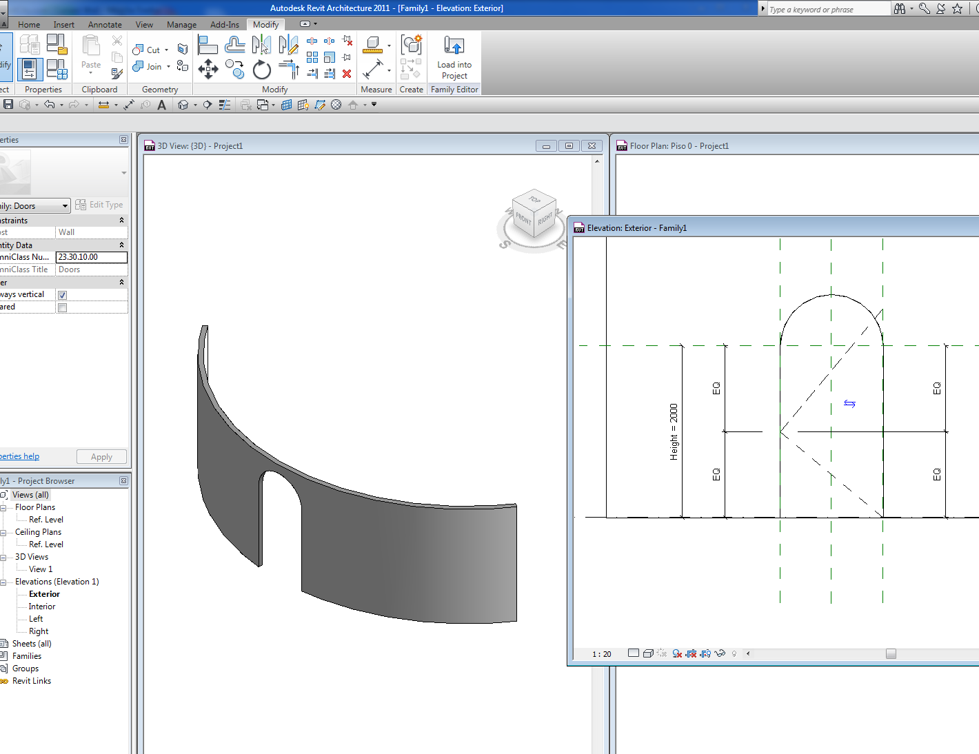

I have a curved insitu wall that i need to put a curved opening / arched door way in
making the wall is simple, how do i go about the curved opening in ?
thanks

You can create that in several ways:
- Create a VOID with a "In-Place" in category Wall or
- Create a "Door" family with the opening (without any door panel) like you can see in my image, in this way you can control all parameters like width, height, radius and so on..
Curved wall and curved window
