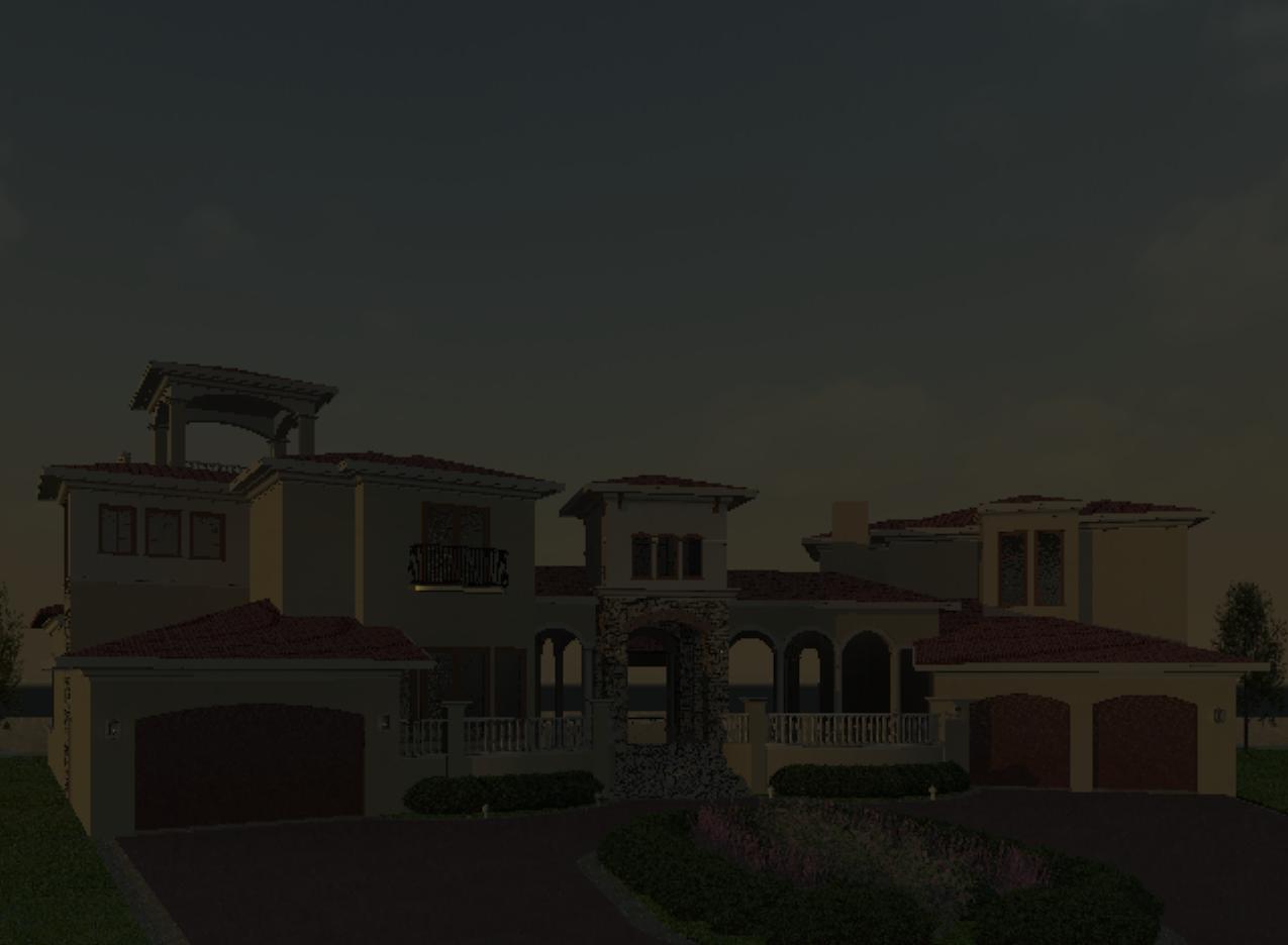

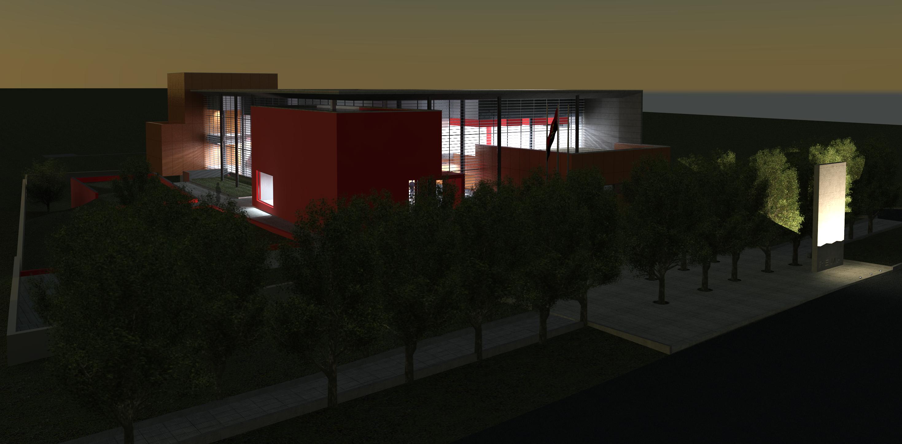

I am getting so frustrated with the lighting in Revit. Is it me or is it extremely complicated/annoying/nearly impossible to create a nice nighttime rendering and get the ligthing correct.  When i do and rendering and set it on exterior: sun and artificial and change the time for example to 5:00 or 6:00pm the lights dont really show but if i change the settting to exterior: artificial only the lights are great but then the scene is to dark????? So frustrated but still smiling. :-)

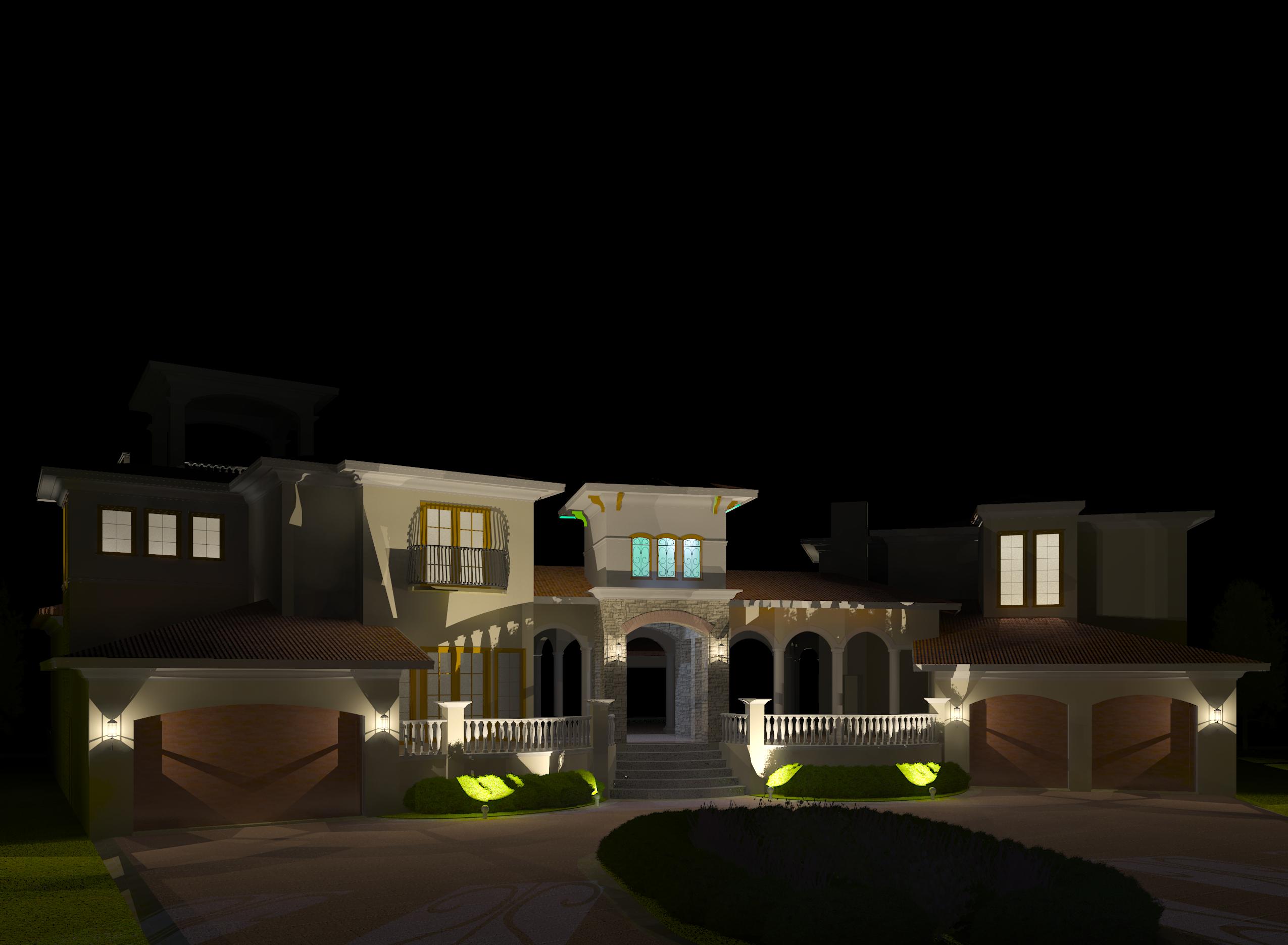

First Attachment is with settings on Exterior: Sun and Artificial and the Second attachment Setting are Exterior: Artificial only.

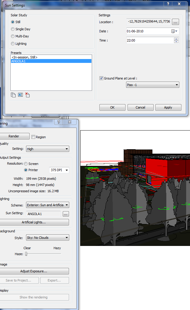

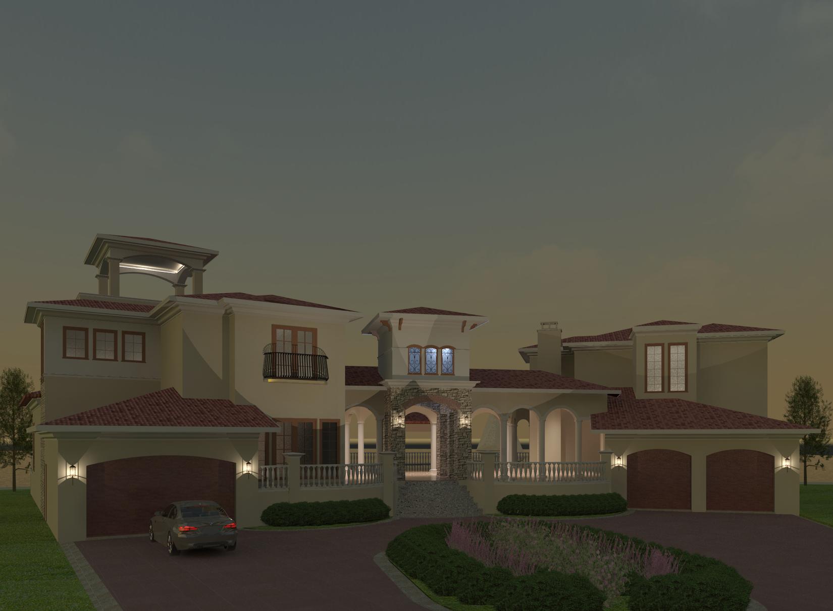

I create this one one and i think it's fine, play with adjust expose after the render.
Hope this help

This one....

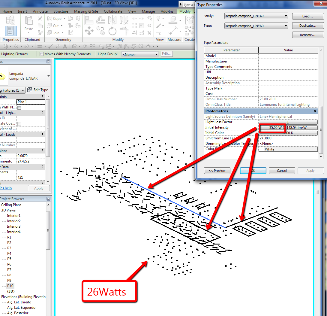

Looks good, what are your interior and exterior light watts?
Tue, Nov 8, 2011 at 2:30:01 PM | Revit 2011 Exterior Lighting
Joined: Tue, May 22, 2007
5921 Posts
4 Stars: 205 Votes

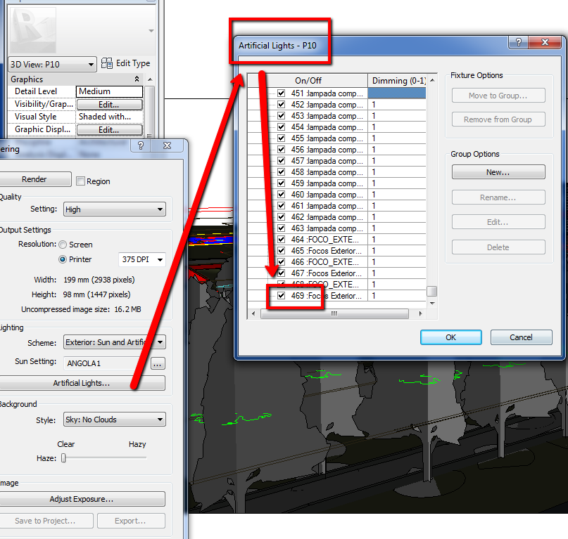

Well i have almost 470 lights in this model, 26 to 35 watts

What is your exposure set at and What about your exterior spot light settings?

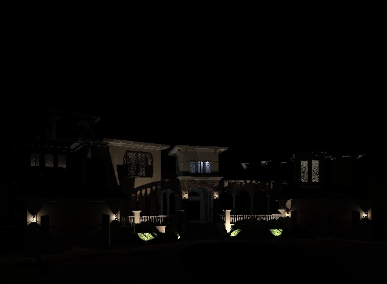

This is Artificial only, I hate my spot lights right now but I think im getting the lighting and such closer to where it needs to be.

looks really good render, maybe reduce the watts of the spots as you say, and add something to the entrance.

Getting closer, Still not 100%

Much, much better....

I see that you really have to play with the exposure settings to get it right.  I usually just leave that stuff default thinking that is already the best setting.
