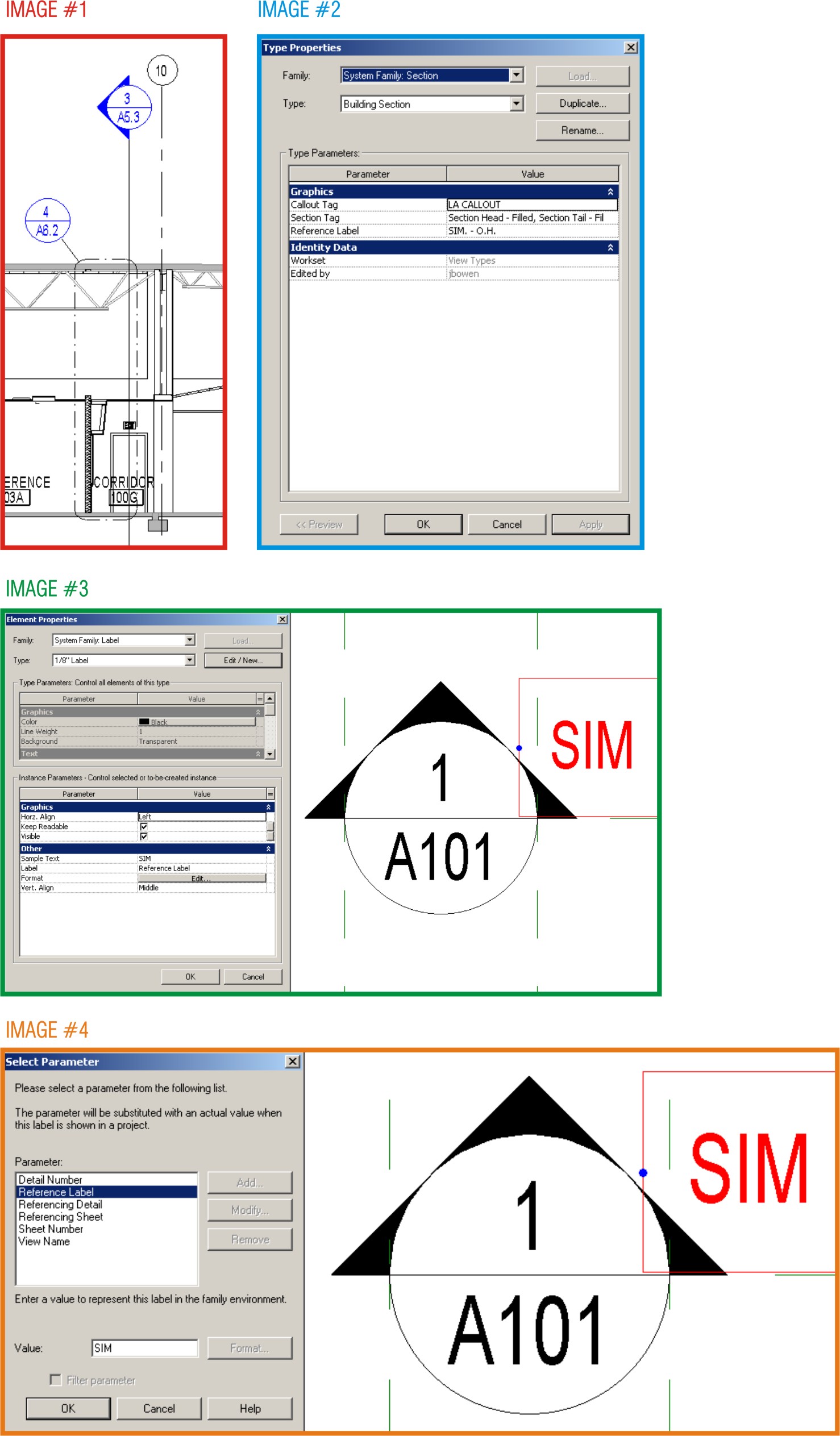

I copied Revit's standard section head and increased the text size to meet our standards. I loaded the new head into my project and changed it Settings > View Tags > Section Heads but now the Reference Label (out beside the actual head for typing text like SIM) will not appear. I type the text under the proporties of the head and it will not show up. HELP PLEASE!! I've attached images to explain...image #1 is what they look like once in the project...image #2 is the properties of that section head in the project...image #3 is the actual section head annotation family and its type properties...image #4 is the section head and its parameters. Thanks Post edited on 2005-12-06 12:43:06

The SIM text will only show if you 've used the reference other view option when creating the section/callout. Otherwise there is no need for it to show.

Sorry I didn't realize that was something it did automatically. I thought it was edittable. Thanks for you help!
