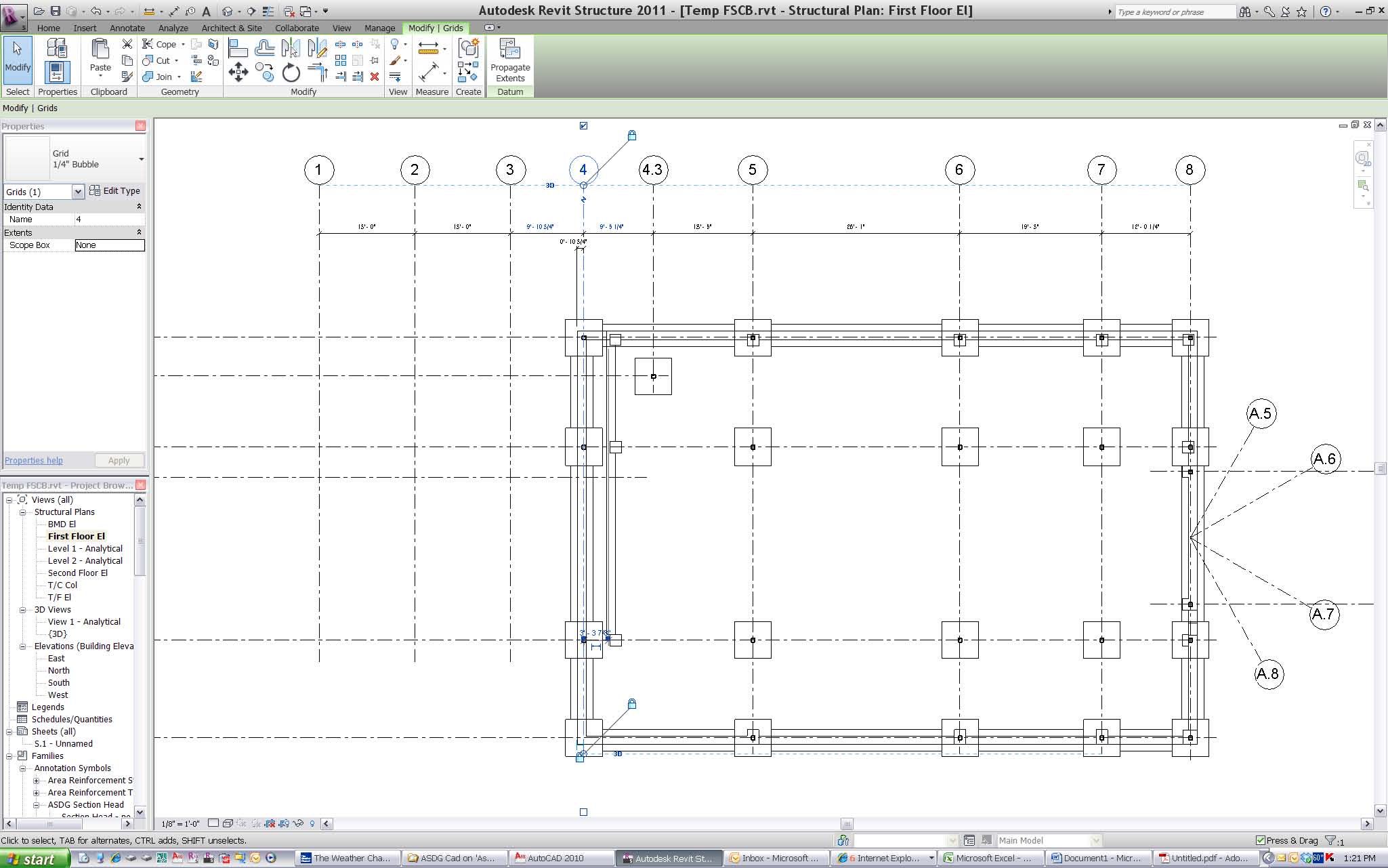

I need to move my exterior grid line, but I can't get the foundation to move with it.  The beams, joists and footing moves but not the foundation wall (stacked) or the concrete column does not move.
I can't use the align tool because my grid line is offset from the face of my wall.
So, what is the easiest way to do this, to get everything to move together?

Create a dimension and lock it

OK - I tried that.  It partially worked.  It only moved the wall that it was dimensioned to (as shown below).  I don't see how to select all the stacked walls in the dimension.
