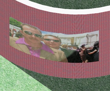

Do you mean you are trying to place a JPEG image onto a modelled water tank? You can use the DECAL tool to do this. In a nutshell- 1/ pick the decal tool from the Modeling tab in the Design bar 2/ select the JPEG image you wnat (it must be at "full size" to avoid pixellation if you increase the size from a normal photo size) 3/ you can adjust settings for reflection of the image etc. 4/ run the render and you will see you JPEG image on the tank. I have given you an example on a circular brick wall I hope this helps/what you wanted answered!
