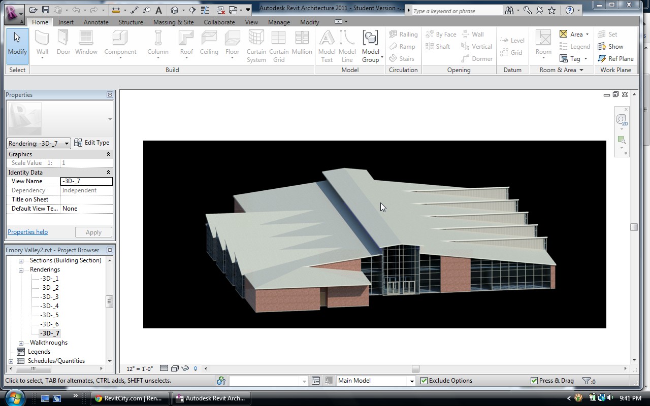

I am trying to render my 3D view in my project. Every time I do this, my background is completelly black even after applying color, image or adjusting.... I do not know what the issue is.. If you can help it would be very appreciated. Thanks   Revit Architecture 2011

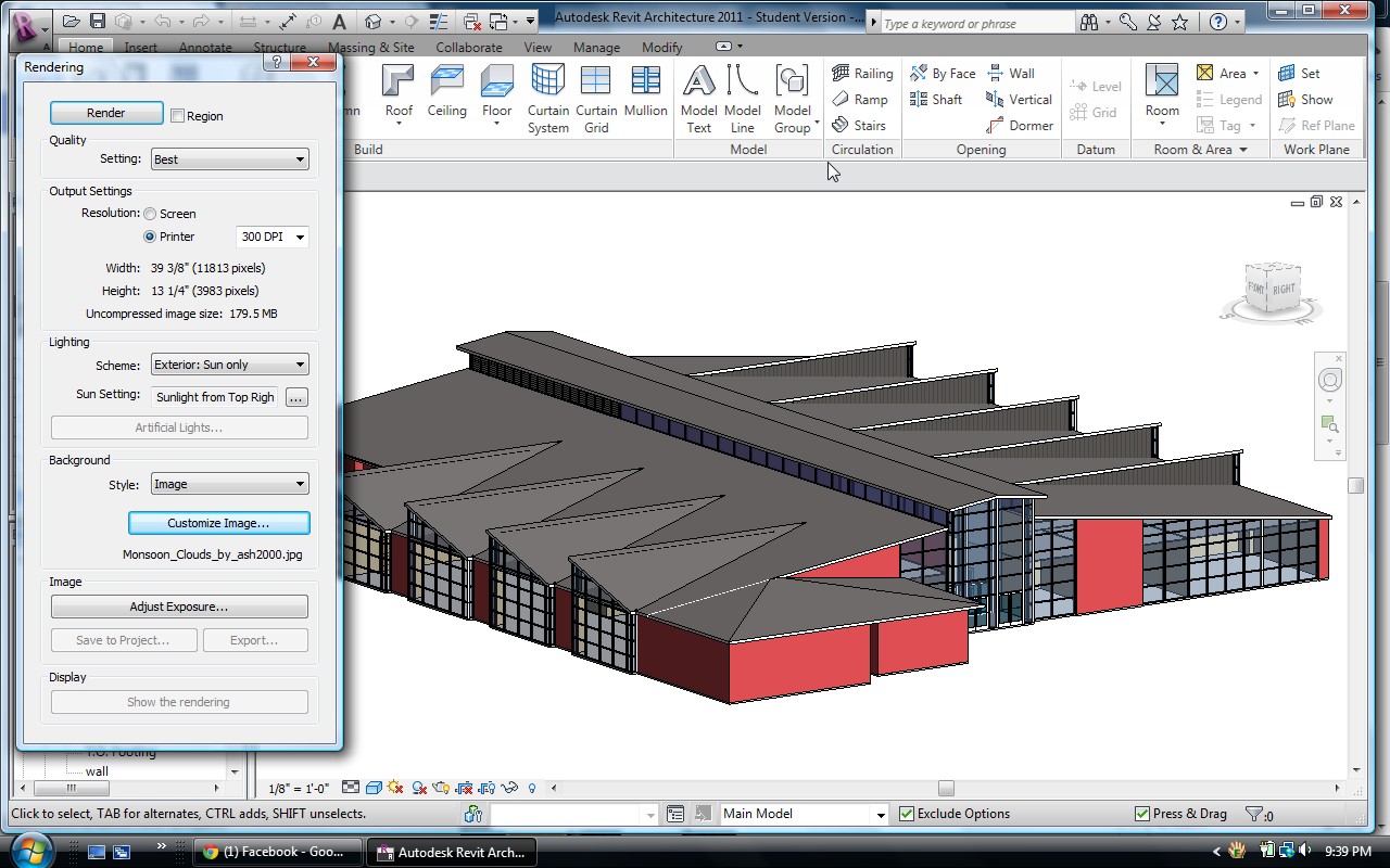

I am rendering with exterior sun and a background image, but the background is blacked out, I have changed my image several times

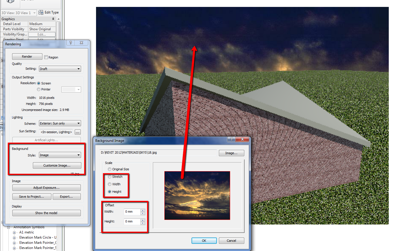

You need to "Customize image", change the "Width" and "Height" and your background will appear.

tried that Typhoon... even tried to resave it as a template and reopen it as a new project still just a black background after I render

Are you using a "Background" file like I post in my image OR are you using a "DECAL"?
Can you post some sceenshots like I post before so we can figure what's going on?

here is what it looks like rendered. I am not sure how to copy and save the screen shot to a jpeg

Right now I can't test that but try this:
- Create a "CAMERA view" (not a 3D view like that) and render with that background.
Then post again a screenshot with the result.

Fri, Nov 18, 2011 at 2:59:41 AM | Render
#14
Dafpfy
Joined: Sat, Dec 29, 2007
286 Posts
3.5 Stars: 11 Votes
your render is 12000px / 4000px
i suspect that your background image is much smaller and is just in the center of your render but behind your model,
