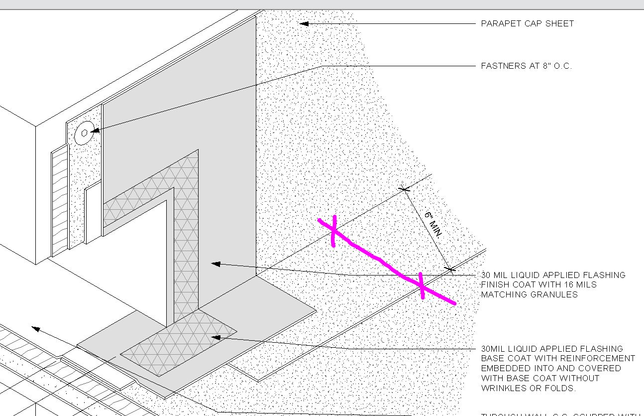

I am having the same problem, have had it for years and still have not found a solution. In the attached image, the dimension line is at a 90 degree angle to the reference lines. Since this is a 60 degree axonometric (its a drafting view) i want the dimension to be 60 degrees as well, like i have shown in pink. Does anyone know a solution to this? My work around has always been to draw some tiny 'fake' lines (so small you cant seem them when you print) and have the dimensions reference those instead of the actual lines I am trying to dimension.

Fri, Sep 28, 2012 at 3:09:38 PM | Isometric Dimensions in Drafting Views (details)
On true - 3D images, locked views, you can dimension in 3D but what you want, you will have to fake.  Put in a point to dimension to and over-ride the dimension.  The text and dimension will not be skewed though.

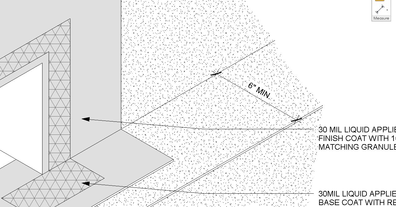

Fri, Sep 28, 2012 at 3:13:08 PM | Isometric Dimensions in Drafting Views (details)
pepsiqueen
pepsiqueen Avatar
Joined: Thu, Feb 17, 2005
136 Posts
Yeah, that sounds like the same work around i have been using for years. looks like this.
