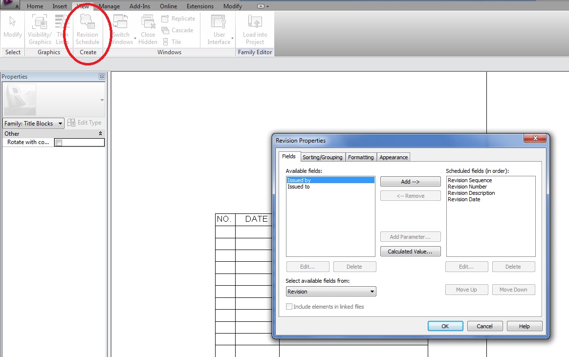

in your titleblock family, create a new Revision Schedule. You can then stretch the schedule to have as many rows as you want.

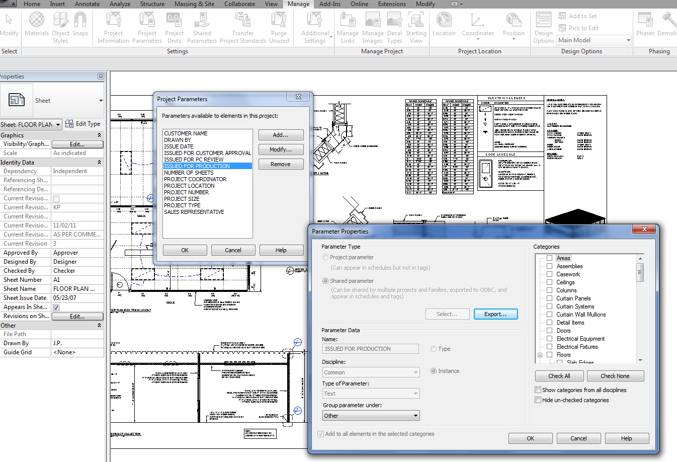

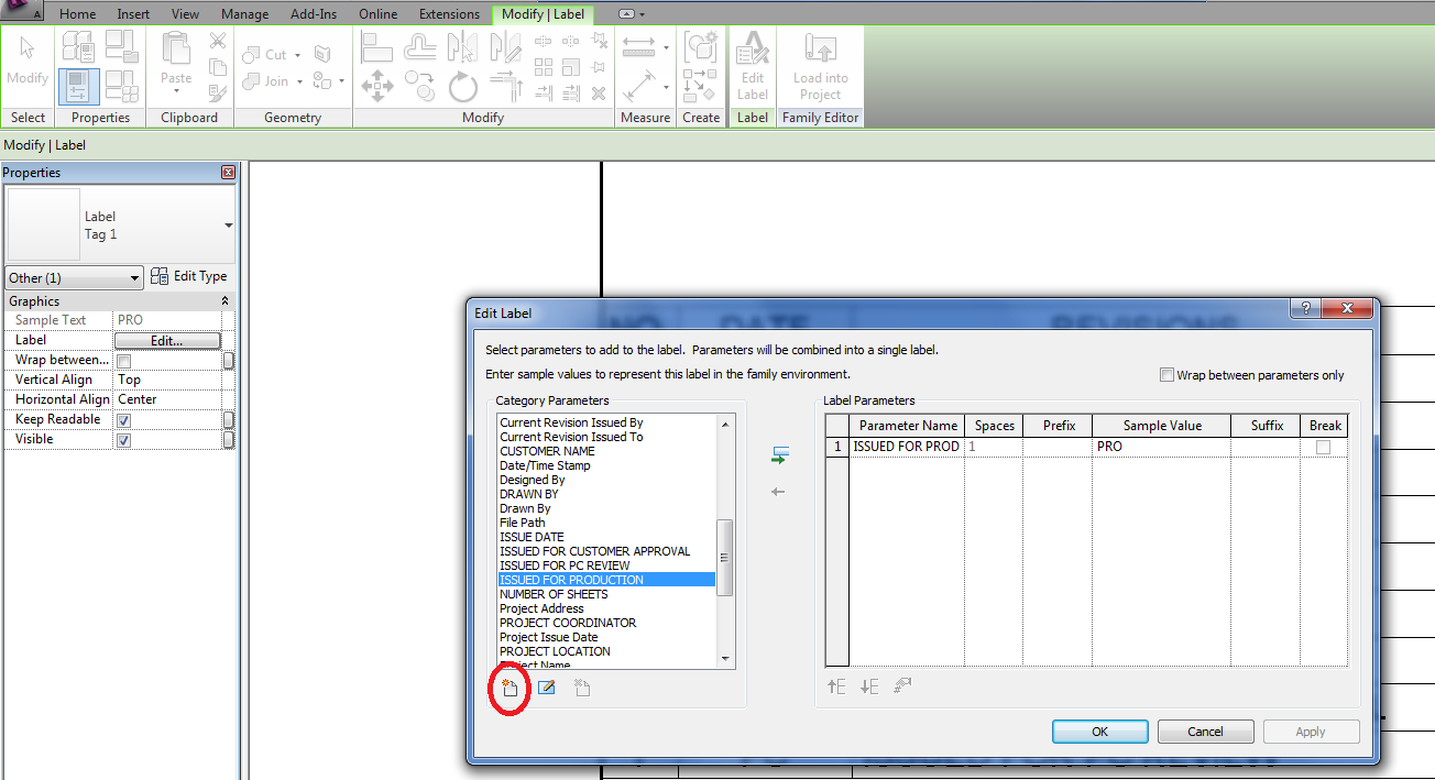

Your on the right path, in your titleblock family, when you create a new label, the "edit labe" box pops up. In here, hit the "add parameter" box. Once you've created all your labels, load into your project.
Once back in your project. You'll have to create the shared parameters which are connected to your titleblock parameters. As TKennedy mentioned, you'll have to read up on Shared Parameters, its too complex to explain properly in a forum post.
