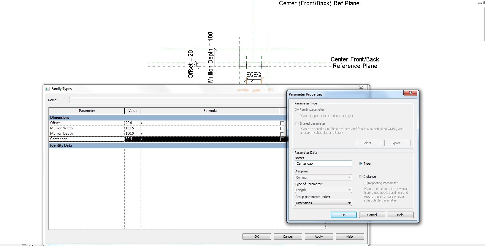

Thu, Oct 27, 2011 at 8:13:09 AM | How do you edit mullion profile parameters
I can add Type parameters to CW Mullions - See attached.
System families like stairs / railings / curtain walls - use special routines so obviously, they limit what you can change so they DO make sense.  If you want something different, you can create an add-in app that will do what you want.

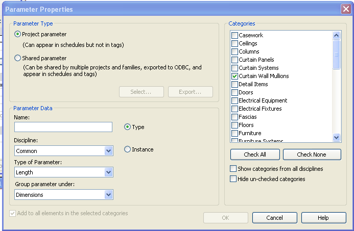

where is that menu you shown, heres what i get when i go to parameter properties for mullion profiles.
i wouldn't know where to start to make an add-in app, would like to know though.

Thu, Oct 27, 2011 at 9:17:01 AM | How do you edit mullion profile parameters
The menu I showed is project level added through the manage tab.  Obviously those parameters can not control the mullion but they are good for any special identification needs that may need to be scheduled or reported.
