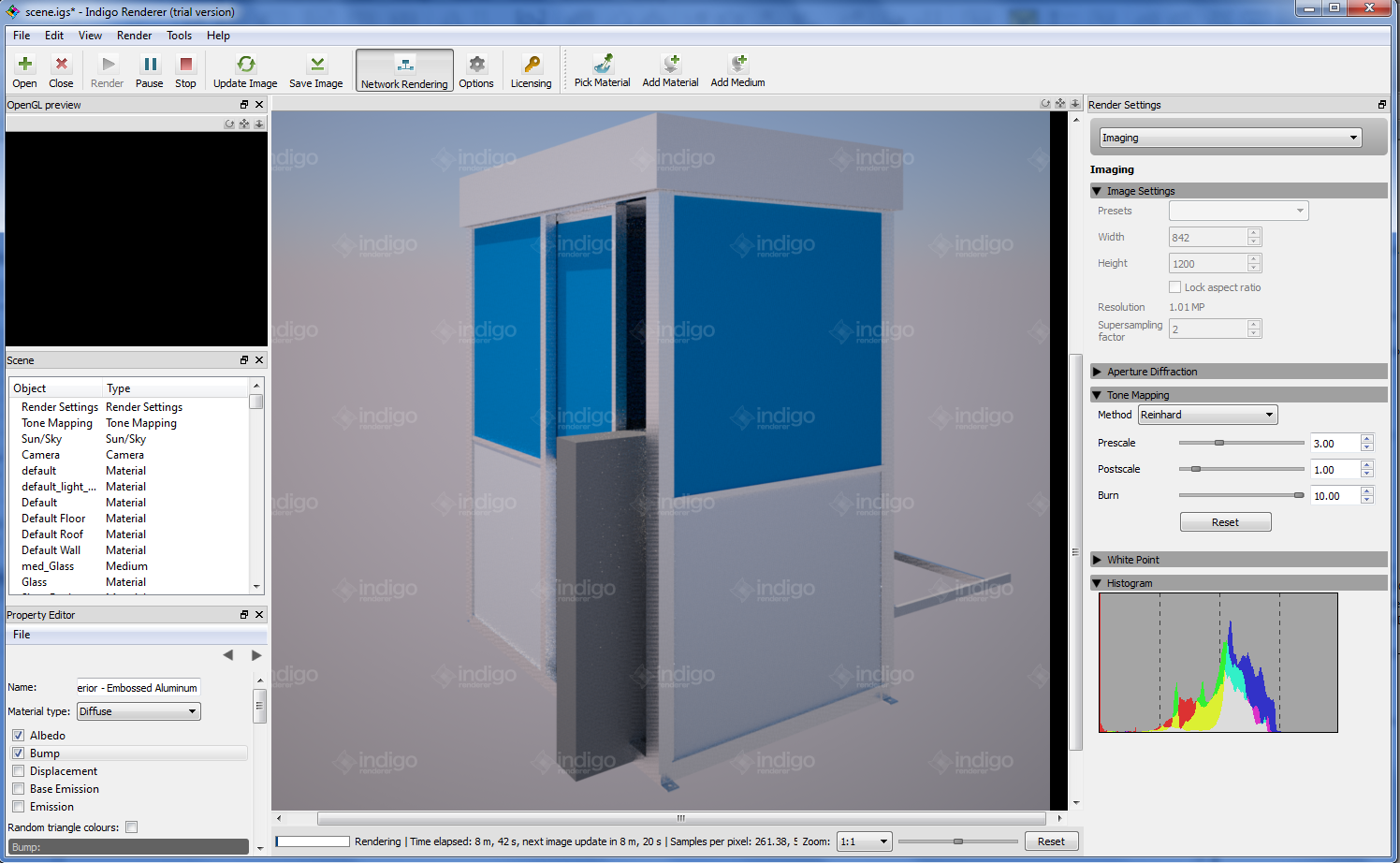

Has anyone used Indigo for Revit software? I have never heard of it before but images look great.
 you might check for yourself http://www.indigorenderer.com/revit/
Looks worth spending money on it but before I do that would like to hear from someone who is using it.
Cheers

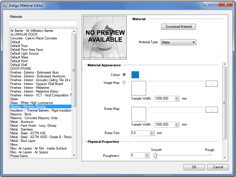

I installed the trial version to test it out and I don't like. Mainly because it doesn't recognize your Revit materials. It carries over all the names but you have to assign the Indigo material to each one. Also, it kindof renders in layers, the progress bar at the bottom is only an illustration of progress per layer but you have no idea how many layers there are and each one takes longer than the one before it. It gives no indication of how long it will take. The thing I really don't understand is the random geometry that showed up in the image. The frame sticking out on the right and the grey rectangle sticking out the door, I have no idea where these came from. I'd rather stick with Revit's renderer.
