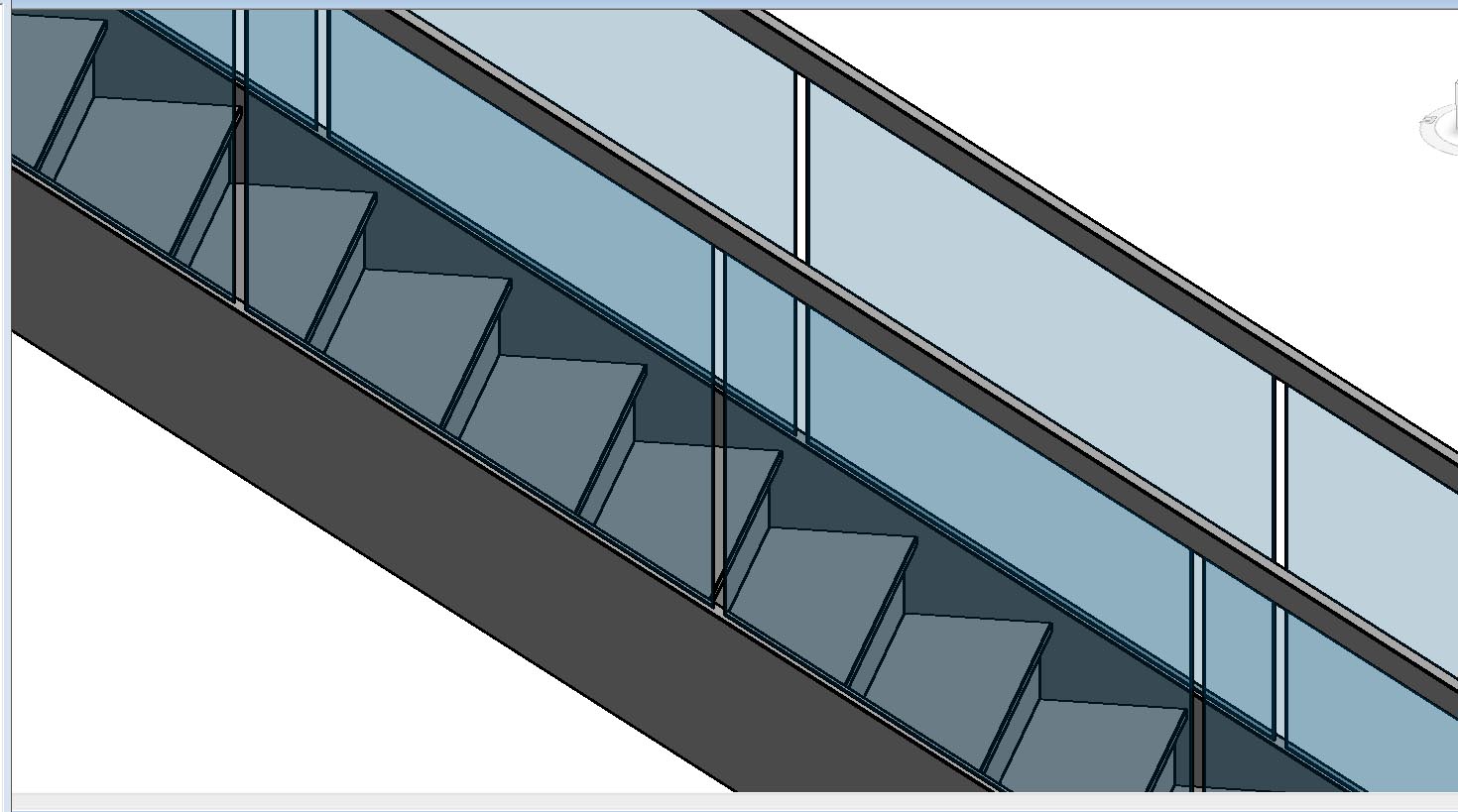

I've been working to create a star with a glass railing where I'm using a baluster template. Among other issues, I've been having a strange thing happen as I've been making adjustments and wanted to see if anyone had encountered it and found a solution. The baluster/Glass panel I'm using is supposed to have 1" gap top and bottom per template file.

Just kidding. This site is not allowing me to attach images for some reason. What is happening is that the bottom of the glass panel baluster is changing arbitrarily as I make adjustments. Some of them are appearing correctly and others are different. There's no other offsets applied to baluster placement. Does that make sense?

Too many locks.  You want to lock the sketch lines of the railing panel to the reference planes, not the other way around.
