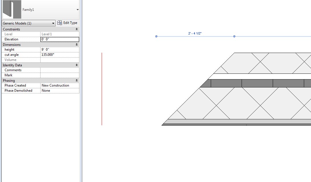

Is there a simple way of creating a wall that has an angled end profile?

sadly, no.  Cutting it with an in-place void family is your best bet.  I wouldn't be surprised if someone has uploaded a wall-based parametric family that can cut its host at a user-specified angle.   That would also be pretty easy to make.

decided I shouldn't  make promises like that...
Here's a family -- revit 2012, which allows you to place on a wall surface a void family which will cut the wall at an angle you specify, to the height you specify.
sort of a crude, quick family, but it saves time over modeling a ton of individual voids.

That is what i thought...thank you very much for the tip and the example.
