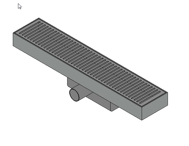

Hello I am trying to make a parametric drain for the bathe room. The drain cover has holes( Voids) for water acess. these are copyed. when i change the lenght of the drain i need a parameter that makes voids to apper in the correct array dimesion. and also keep the sam distance to the ends???

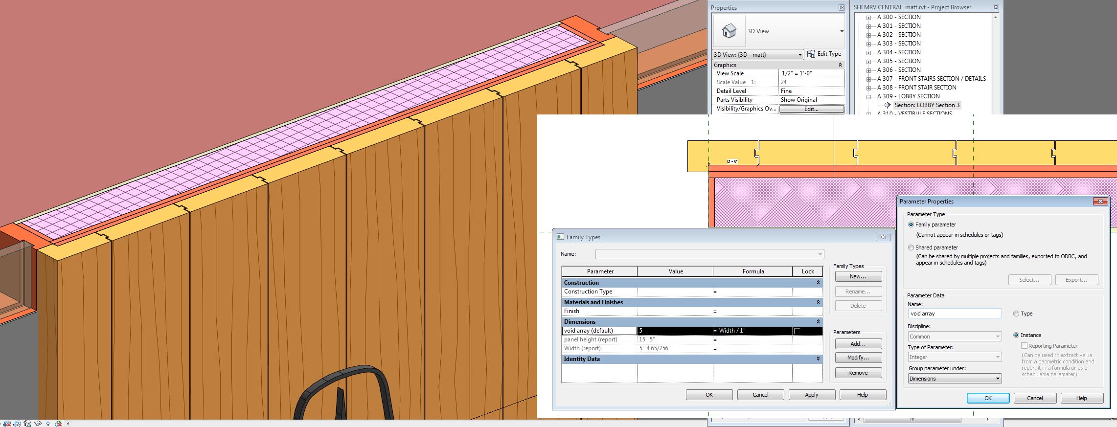

Parametric void arrays work by far the best if you use a nested void family.  I remember I got that advice after I couldn't get it to work any other way.  Nesting families isn't as complicated as it sounds.
Important thing to note is to save the width/spacing as an integer (rounding) so you can use it for the array number label.
In the attached pic, the nested extrusions stretch to match any height, and array across any length of walls.
Edit:  For your formula... try.. (width/1")-4".  This will fill the space to the nearest inch, leaving 2-2.5" at either end.
if you wanted the holes to remain absolutely centered even with an arbitrary length, try a new parameter for the dimension from the edge of the grate to the first void:   .5(width-(width-4")) as a non-integer number.
The purpose behind this formula being to split the remaining uncut top plate equally... It's easier to divine that number than anything else.   You have to lock your array to a left/right plane.  "Centerline" is not a suitable plane for an array to dimension from, which was my first instinct for making symmetrical voids--IE, two arrays going left, and right.
That formula will probably explode in your face, I never have luck with parameters on the first try.  But give it a shot.  Good luck.

Here is a parametric example of what you are trying to achieve.  I would probably hide all this geometry at everything but fine detail level to avoid performance impacts and a big block blob in plan...
