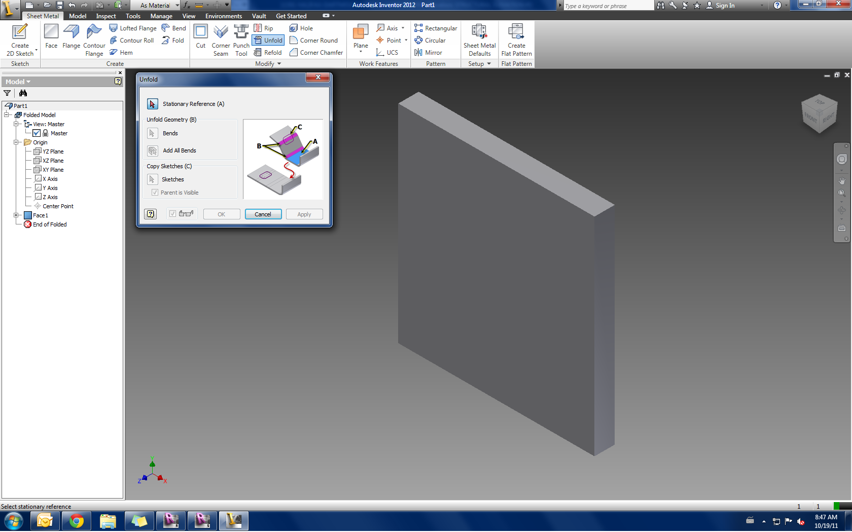

Revit cannot do this. I prefer Autodesk products so I'd recommend Inventor. Their sheet metal tool is really easy to use and is designed for export to CNC equipment.

Whilst we've done this in Revit and have developed an API to automate the process.  For OOTB inventor would be a better solution.
Just note to work in inventor with the sheet metal tools, all the geometry needs to be modelled natively in Inventor.  Its pretty useless at working with imported geometry from tools like 3DS Max, AutoCAD etc.
