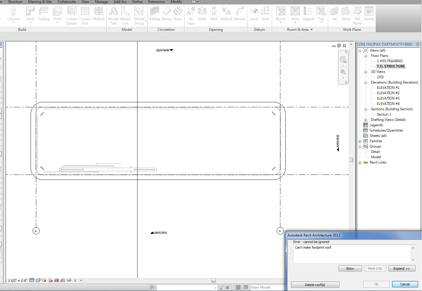

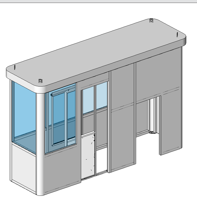

I'm trying to create a flat roof with round corners but I keep getting "can't make footprint" when creating the boundary. Is there something I'm missing? To get around it, I made a floor with the same structure and it works and then I'll create the fascia with an in-place sweep but there must be a way to use the roof properly, right?
Fri, Oct 14, 2011 at 11:14:45 AM | Roof Footprint - Fillet corners
I have no problems doing this in 11 and 12.  Did you turn off the defines slopes for those corners?

your the man WWHub! I thought giving it a zero slope would do the job but turning off 'defines slope' worked. Thanks.
