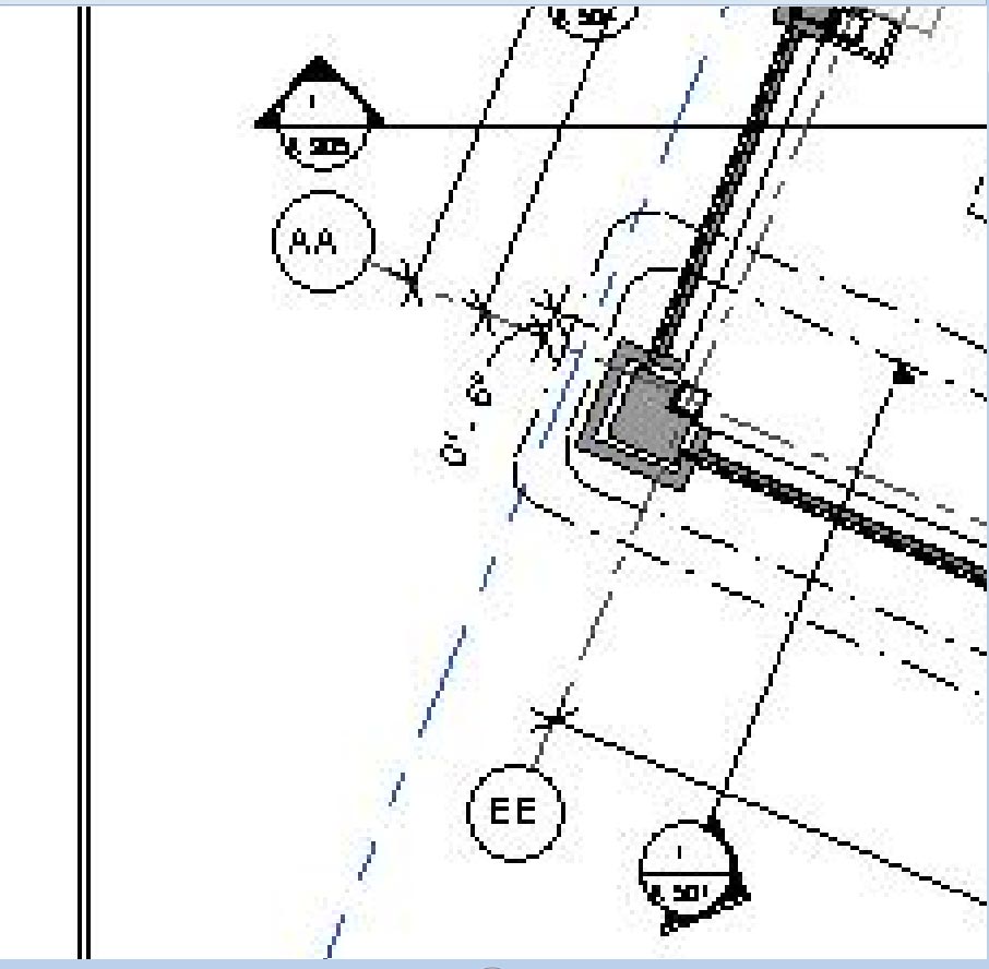

if I export my sheets as images at 100%, does it print to scale if I send it to the printers?  Has anyone done this before?

No... print your sheets to PDF for a better effect.
My image saved at 2600 pixels at screen resolution, AKA 92 DPI.

if your sheet is 11x17- and you export that sheet/image at 100%- it will fit perfect on the 11x17 paper you print it to.. as for scale on paper- it will print the scale you have on the sheet..

that pixelation you are showing us won't happen if you export the image at 10,000 pixels and then resize the image for printing or viewing..

I know, but there's an option in export images of "zooming" to 100% instead of fitting to an arbitrary pixel number, and I was pointing out that zooming to 100% will give an awful result.

set it at 100% and turn the "raster image quality" all the way up.. no awful results then.. what am i missing?

ego- actually you are more right than wrong.. even if you do turn up the raster quality it's really no longer exporting 100%..
