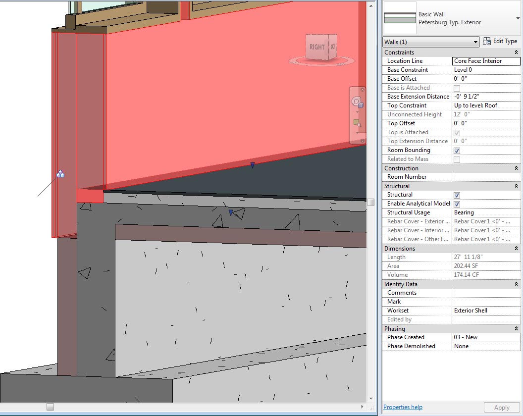

Wellllll, I'm not sure I'd do what the contractor is asking... you can unlock adjacent wall layers to have a "base (and/or top) extension distance" that you can control.  IE, the siding and rigid insulation can be stretched down below the floor which the stud layer is attached to.  makes some pretty crisp detailing at the model level.
pics related.
