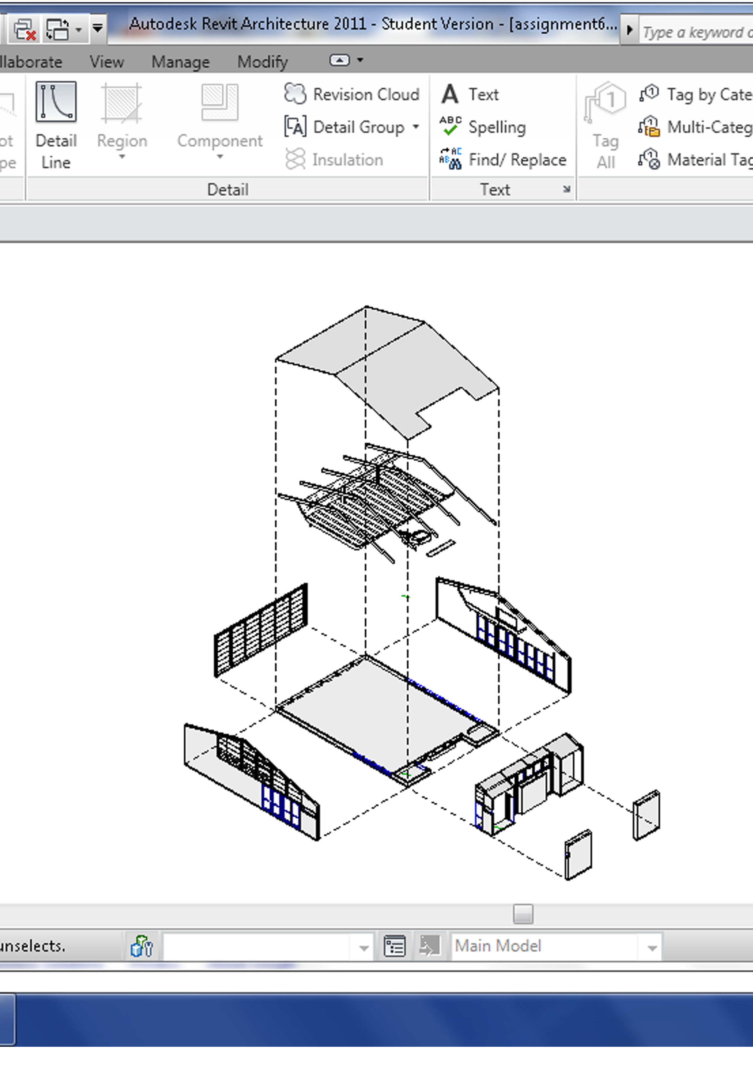

Hi guys,
I have a problem here. The elements which I have hide in revit are showing when I export as pdf or img.
Any tricks to this?
Anna
Tue, Oct 11, 2011 at 11:21:55 PM | things is not hiding properly
annateo301
Joined: Tue, Aug 4, 2009
70 Posts
please see attached files..
Wed, Oct 12, 2011 at 6:47:17 AM | things is not hiding properly
Are you really hiding it or are you using the temporary hide?  Sunglasses are temporary only and irems still print.
