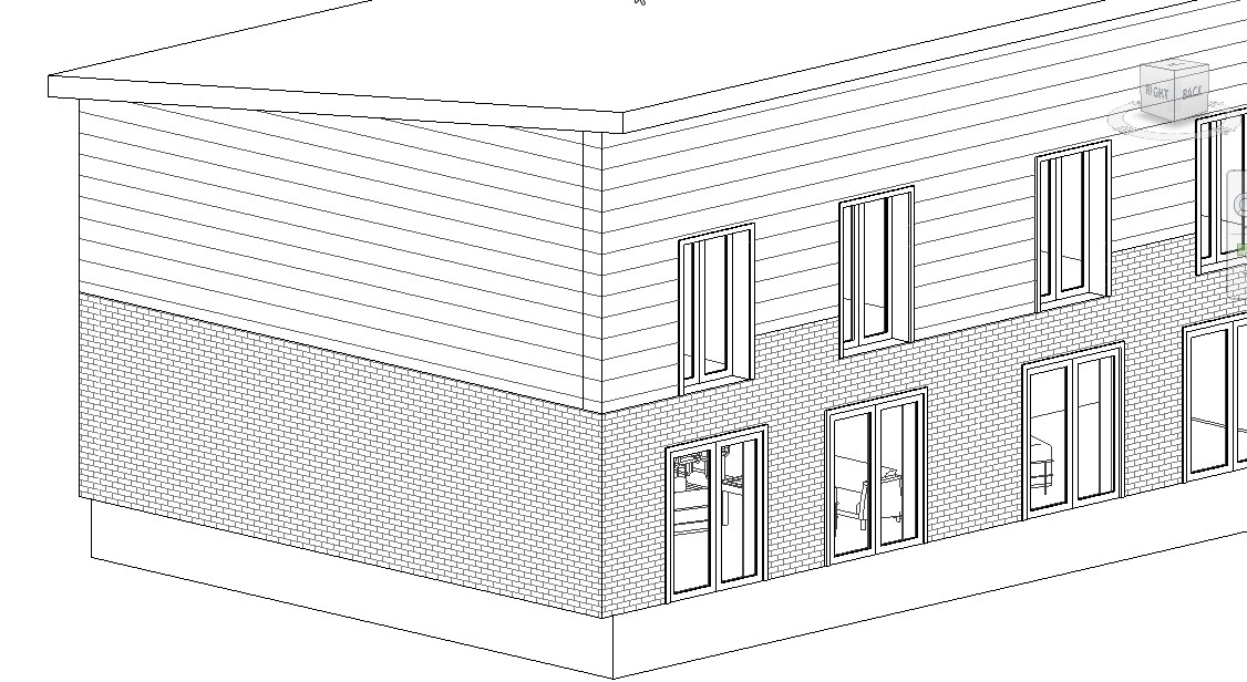

Hi Guys and girls.
I have som probs with lines showing in 3d at wall corner joins. Same type same location line and so on. Look ok in plan view but in 3d the interior face line shows. I have fixed it a coubel of times buy delting and or using the corner tool but this time it won’t go away!! And I would like to know what I am doing wrong.

We need to see an image of your wall join problem.  Use a screen capture program like ScreenHunter Free.

Here is a pic.. thanks for the quick reply..

Try editing the joins and use a miter instead of a but join.

Or use the "Join Geometry" tool

FIXed thanks alot.. the mitter worked!
