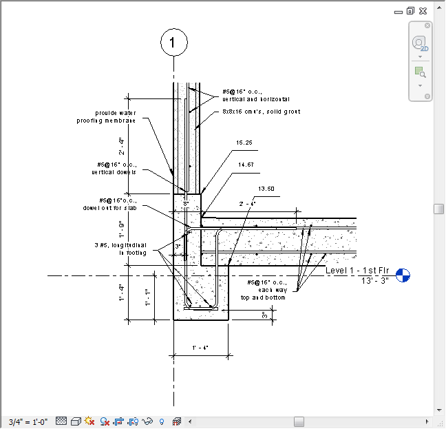

what I did was to create my wall with three layers, one masonry, center concrete, one masonry. checkout the detail, it shows great I think, perhaps you use a slightly different hatch type but that is easy, as previously stated by others.
