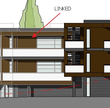

Hei guys,
I have a revit link that is set to underlay so that in elevational views where the link is in the distance we can tell what is up close. The problem is that our material selection is quite dark on the facades and it hard to tell that the link is in the distance.
Is there an option to set the revit link's visual style to lets say, HIDDEN and the view which has the link retain its orginal shaded visual style?
Thanks in advance,
Michael
Be brilliant,
Michael
