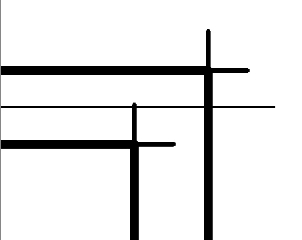

is there any way i can have thinner lines at the en of the walls?
i have attached an example of what I need for my proyect
the middle line is just a grid
i am using revit arch 2011

You will have to add these somehow if you really need them.
Sometimes you just need to change your methods and settle for something less in order to get a whole lot more.

yes. for this urgency i had to create pair of lines with a 90° angle and put them on a group and went corner by corner with a copy paste
anyways i which there was some feature like this since i like how it looks, its like back in the days when layouts where made by hand

You would be better off using a family instead of a group.  Groups tend to slow down the model.  I would make it be 2D linework - in a wall hosted family.  After placing on the one wall face, you can align the other face.  These lines would then turn on / off with the wall and would move with it.
