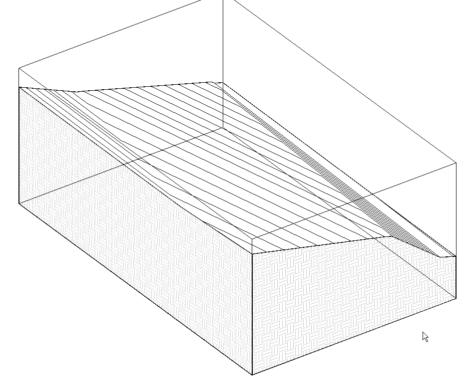

If you use a section box and pull its limits inside your topo, you will get a 3D topography base, not just a surface.  See attached.

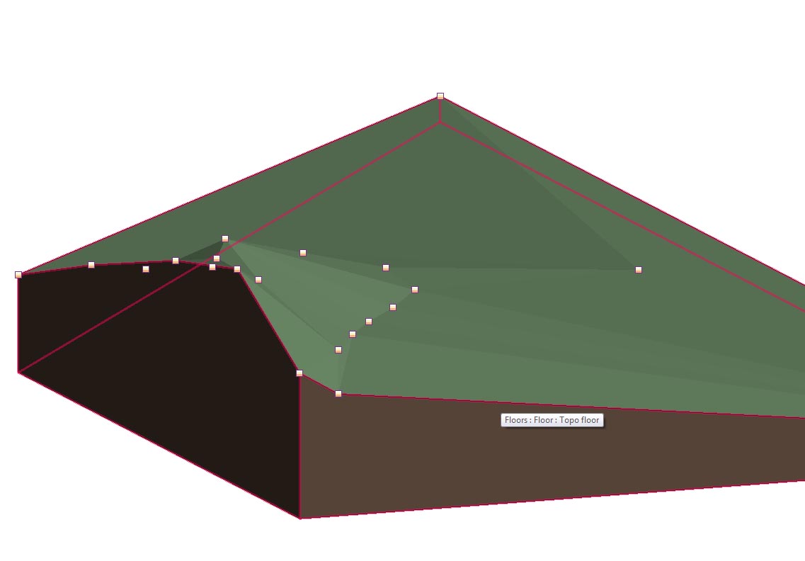

I've always wondered if a floor with a variable-thickness layer of dirt could be used as topo... if the topo point values are copy/pasted into the elevations for control points on the floor.
if that makes sense.  I bet it would work -- but to mimic all the points in the topo would best be done in two separate open files so you can copy/paste values between projects while both floor and topo are being edited...
It'd probably take a couple hours.  But I bet it would work.
So I tried it;  Here's a crude work-around for anyone who isn't suited by topography for whatever reason.  You can even give the layer of grass a nice fluffy thickness...
Edit:  and then, or course, you can apply a surface texture to it if you'd like.

I think this is quite possibly what i'm looking for. It's a shame though that Revit lets you do this yet it doesn't have a simple option to convert the topo to a solid floor slab. This would be great for many reasons as you'd be able to break the floor into different assemblies for road/pavement/curb construction etc. Topo is great for visualisation but a ground should always have depth Winking
Hopefully they will look at encorporating it into future releases
Okay I've just done as Myalterego suggested and it worked great, just a few issues which i'm sure are probably unresolvable (but doesn't really matter too much as it's nearly there and noone will ever notice on the 3D model)
1. Is there a way of slicing up the floor, just as you would create subreagions or split surfaces on a topo? I tried Copy and pasting the floor to create a duplicate, then edited the boundaries thinking it seemed logical, however because it deletes vertices rather than just slicing it and creating new ones it means that the split floors when next to each other don't quite line up, as i said not a major issue as you would never get slabs/pavement lining up with grass anyway. It would just be nice for quick editing purposes.
2. For some reason I'm not able to place the points in exact locations (like you can with topo points) they just won't snap to anything am i missing something obvious with this??? obviously due to this you'd never be able to match the topo exactly.

I exported to CAD the section box I posted earlier and it produced the solid base.

It only creates a polyface mesh Hub, which then has to be draped to create a solid, and it still doesn't show a depth when exporting to stl, acis, vrml etc.. which takes us back to square 1 lol.  But nice though I didn't know it did that, again quite good for visual stuff if taking into max Winking
