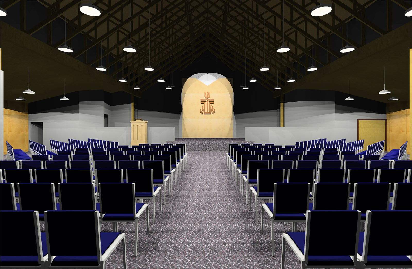

I am trying to render the inside of a church but the upper the roof rafters are under lit (see attached pic). Is there a way to increase the ambient light? What is the best method? Thank you in advance for your thoughts. Chuck

Accurender lite version in revit doesn't have settings for ambient light. You'll need to add studio lights (just a glowing ball of light similar to an omni in viz) to increase the lighting levels.

Thanks I will try using the studio lights. Is there a better accurender available? If so is it worth it and what advantages does it have? Chuck
