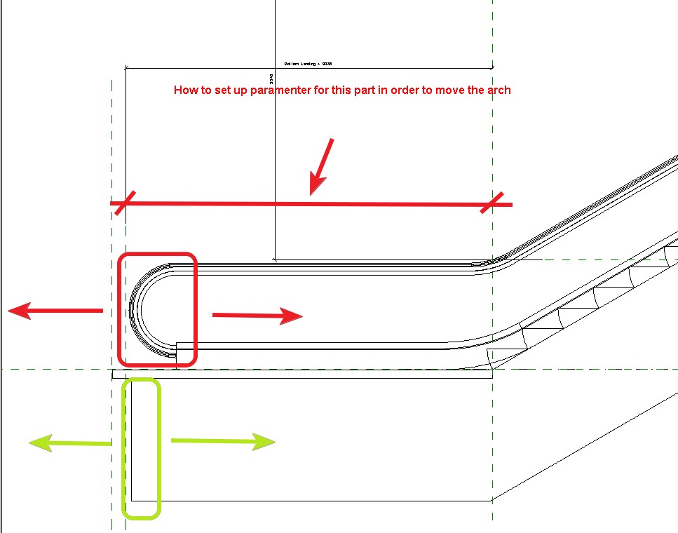

I draw a escalator, and have tried different ways to set up parameters to change the length of the handrail ... however it doesn't work. The handrail always move together with the bottom (green part as the picture shows)
How can I set up parameters to change the lengthes of the handrail and bottom seperately? Please see the picture.
Thank you

Which model are you using ?
Please let me know.Andreas

I tried to draw this one in Revit 2011
Escalator 9300-STANDARD-T-30-100-K 6000 mm 30 degrees 1000 mm

Yes I understand, but which family file are you using?
Br
Andreas

I used Generic models :-)
