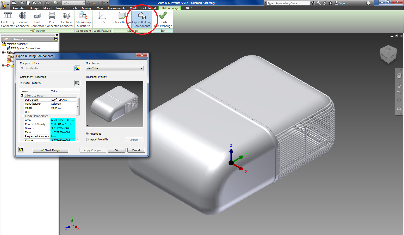

If you create something in Inventor, you'll have to convert to a format that Revit will recognize. In Inventor, hit the 'BIM Exchange' button and then hit 'export building components'. This will convert the assembly to an Autodesk Exchange File (.adsk). Once you have this file, you can open it directly in Revit. Then save it as a family and upload to RevitCity. Please don't post any Inventor files directly to this site as no one will be able to open it.

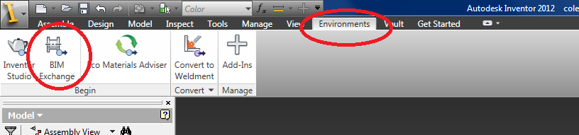

Is the BIM Exchange ribbon a add on? Because I can not find it on Inventor.

its under the Environments tab
What Version of Inventor are you using?
