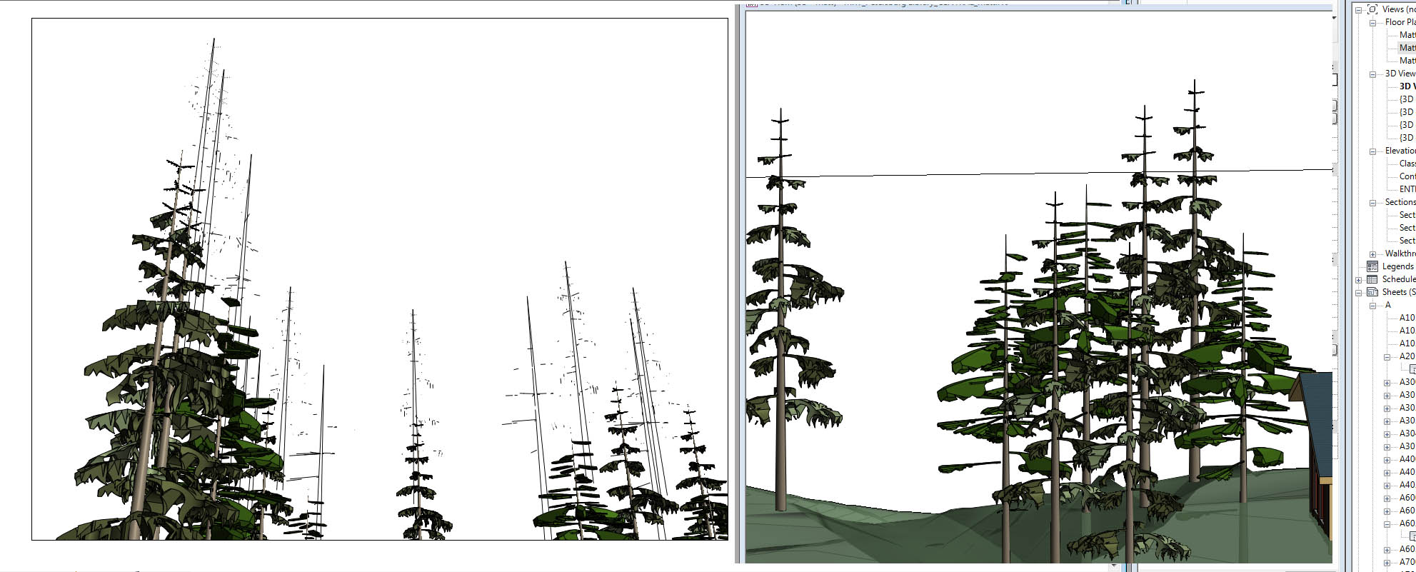

Here's something strange.   Revit arch 2012.
In 3D perspective views, trees in a linked and overlaid site project have left behind a ghosted shell of some of the tree geometries after moving the linked file.  I cannot select these lines.  Selecting the linked file temporarily makes the lines vanish.  I have deleted and created fresh 3D views, the problem persists. I have purged/audited/compacted both the architectural and linked files.  I personally made the trees, and they include no linework or other surprises, and haven't misbehaved in any other projects to date.
Has anyone seen anything like this, before?
Pic related, no evidence of the artifacts in other view types.
