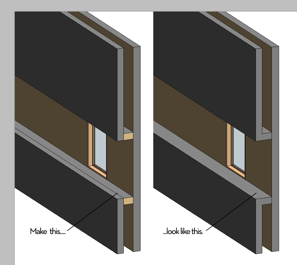

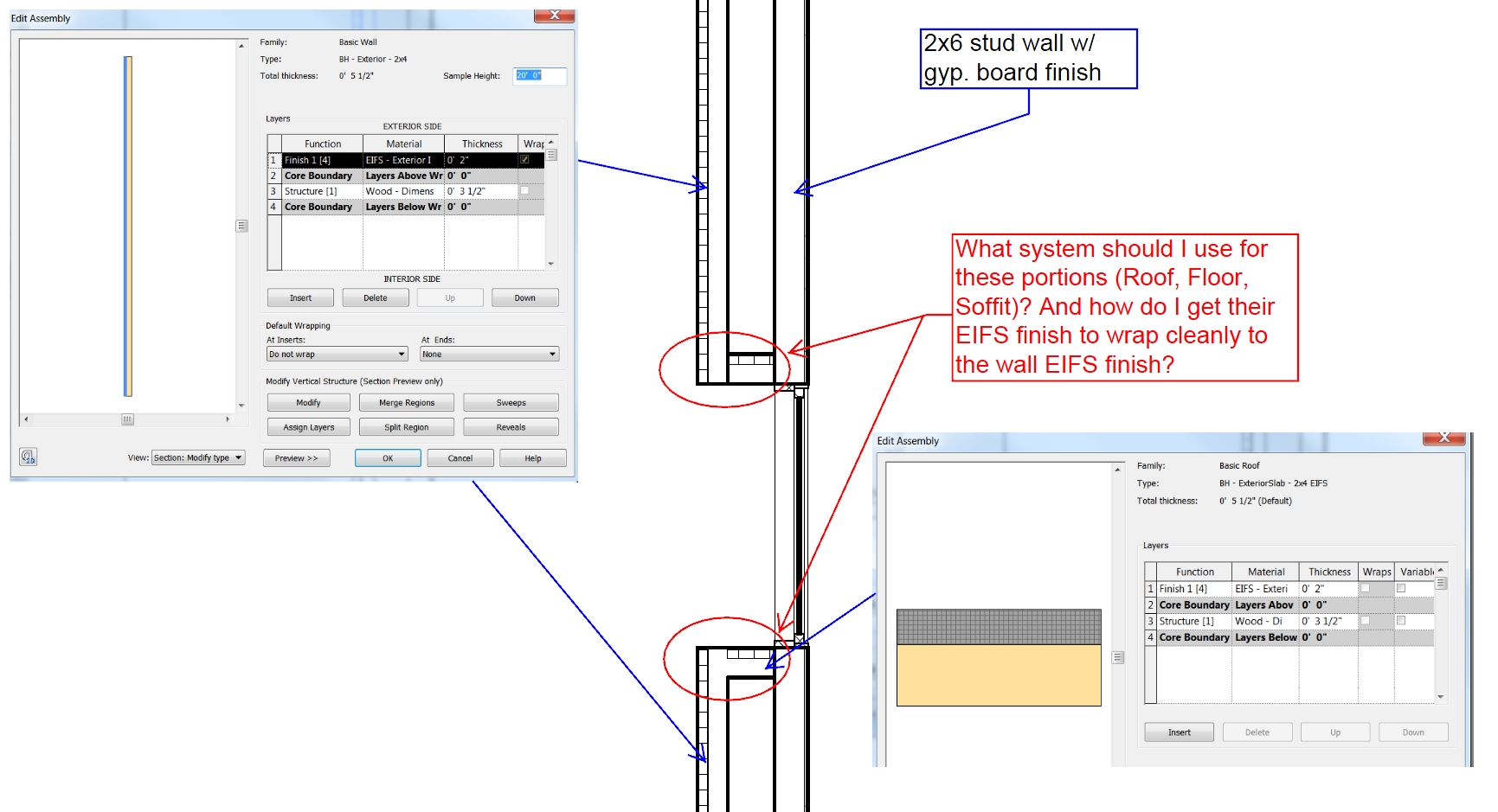

Hi all,
I have a double wall condition where I need to have an outer, lower wall wrap to a horizontal ledge that intersects another, inner wall which is hosting the windows. I need to have the outer wall EIFS finish wrap cleanly to the horizontal ledge EIFS. I have tried doing the horizontal part with Floors, Ceilings, Roofs, etc, without much luck. Anyone know how to do this cleanly and easily?
Thank you for the assistance

Add a wall sweep with your wall finish material.

Thanks W,
I have been searching around for a tutorial on how to make a sweep do what I want (to show the horizontal finish material continuous with the vertical wall finish material), but all I have found are lessons on using parapet caps and moulding. Are you familiar with anything that might illustrate how to make this work?

You can do it with a regular wall sweep then paint the exposed top face or you can do it with an in-place sweep that has an assigned material.  I would probably do it with the wall sweep.
