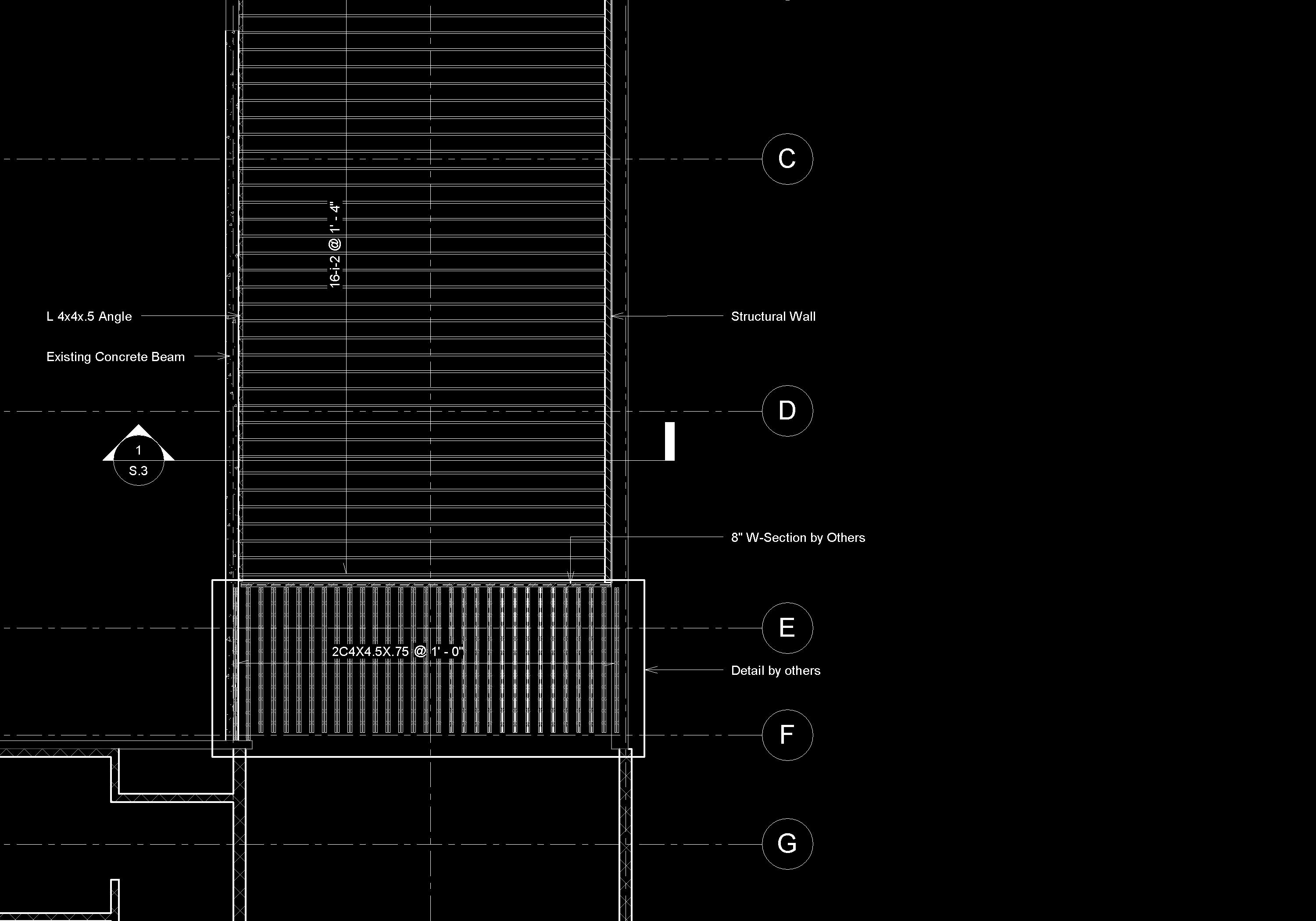

All of my walls are showing the correct cut plane hatch except on my generic wall. My view range is set to see -1"  and i know the wall goes up to 0. type of hatch doesnt matter just want to see it. I am in a structural plan view drawing a framing plan.
Any thoughts?
(Revit 2012)

I assume you are speaking of the provided generic wall. Several things affect the detail of the walls in view, detail levels set to coarse will likely not show a hatch. If the wall itself does not have a hatch assigned to it. Please post a view, and a view of the properties box, with a view of the particular section properties. You may want to download Jing, it is free and is very helpful for capturing pictures of your screen, and sharing with others on the chat or in the forums.

-Detail Level is set to Fine.
-When i edit type i change the material to Masonry and the hatch to diagonal crosshatch.

The wall not showing the watch is next to the wall with the diagonal hatch

Your image makes no sense with your question.
I can't tell if this is the issue but Revit has always had trouble with very short walls.
