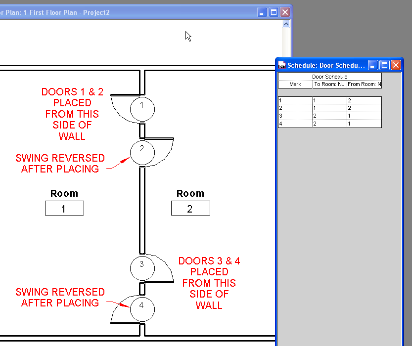

In a door schedule I have a column for the room in which the door is placed. When I insert the door the field is populated with the correct room that the door swings into to. However if I flip the door the schedule does not update to reflect the door opening into the new room. Any ideas? Cheers, Dave

In your door schedule from/to room information can be easily switched. You can just hit the drop down and pick out of the two rooms the door is separated by. The reason for this is the many different conventions on what is considered the correct room of association and thus gives the user the choice.

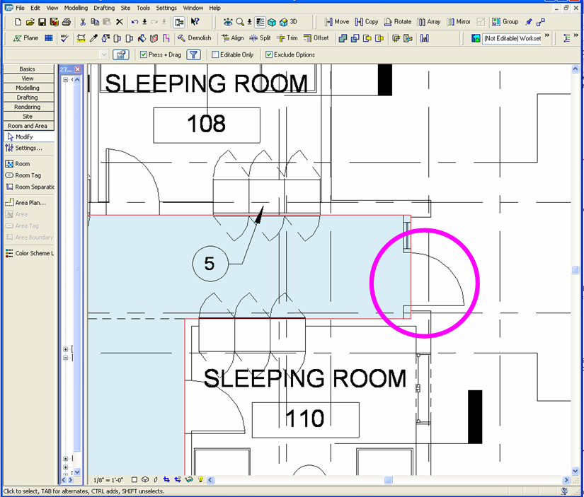

I'm having the problem of no room number association even being provided as an option... which I suspect is what dgehring is having issue with as well.  The door giving me the problem is a storefront system door between a corridor & the exterior.  What is strange is that the room boundary comes right up to the door, no problem.  Thoughts/advice?

I'm not sure what you are asking.  You can't edit from/to information because that is read from the project.
Pay attention to what side you place the door from, then flip the swing if needed.  This is how the room from/to is controlled.  Experiment .... you will quickly learn the process.
