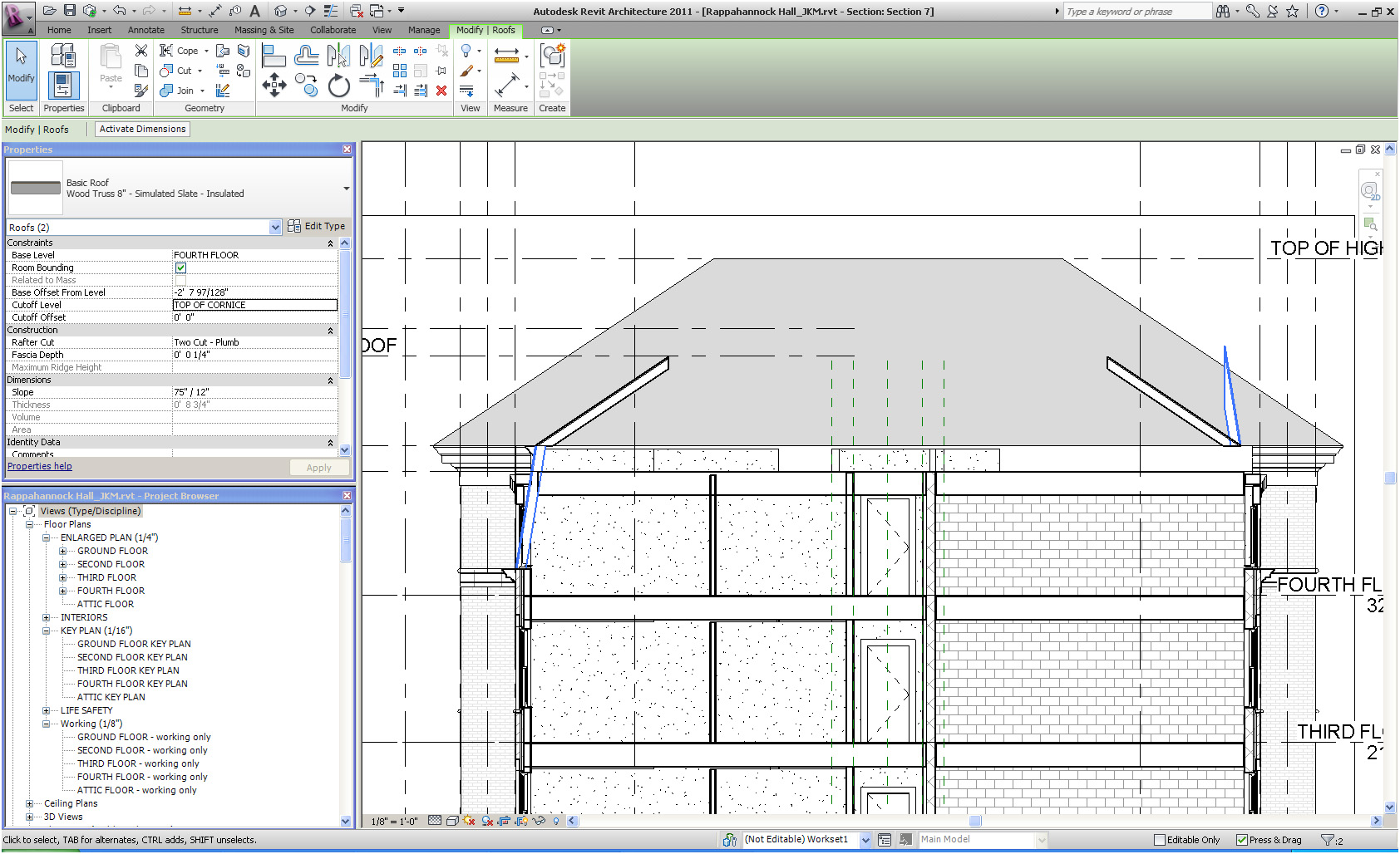

i'm trying to make my mansard roof work. it seems to work on one side, but not on the other side when i mirror it over. as you can see from the inserted screenshot, the left side cuts off the roof correctly below the cutoff level and the right side cuts the roof off above the cutoff level. any help would be most appreciated!
thanks!
i'm using revit 2011

Somethings don't mirror well and sometimes it is better to mirror the sketch.  In this case, maybe you should be following the advice given in this thread
http://www.revitcity.com/forums.php?action=viewthread&thread_id=25289
