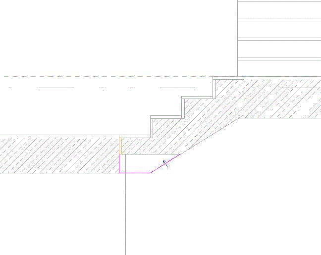

Im trying to use the cut profile tool to make my stairs look correct in section. when doing it with standard monolithic stairs it works fine, but if i try and use it on the monolithic stairs where i ahve applied a tread/riser thickness it doesnt. rather than allowing me to cut the profile of the concrete stair, it only lets me cut the prfile of the first riser/tread.
attached is a picture showing what happens.
any help would be great

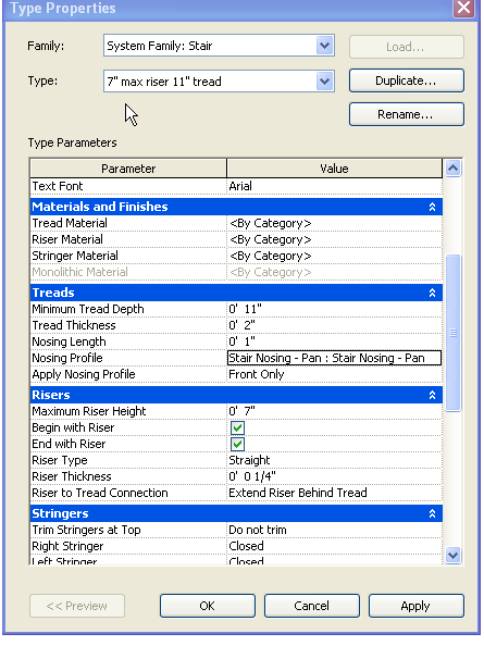

Tue, Sep 13, 2011 at 10:03:38 AM | Stair - Cut Profile
Set the correct profile and you don't have to edit anything.  See attached:

attached is what i am trying to achieve with the cut profile, i want to add that shape to the concrete part of the stair, not the riser/tread as showin in the image.
apologies if i didnt make myself clear.
