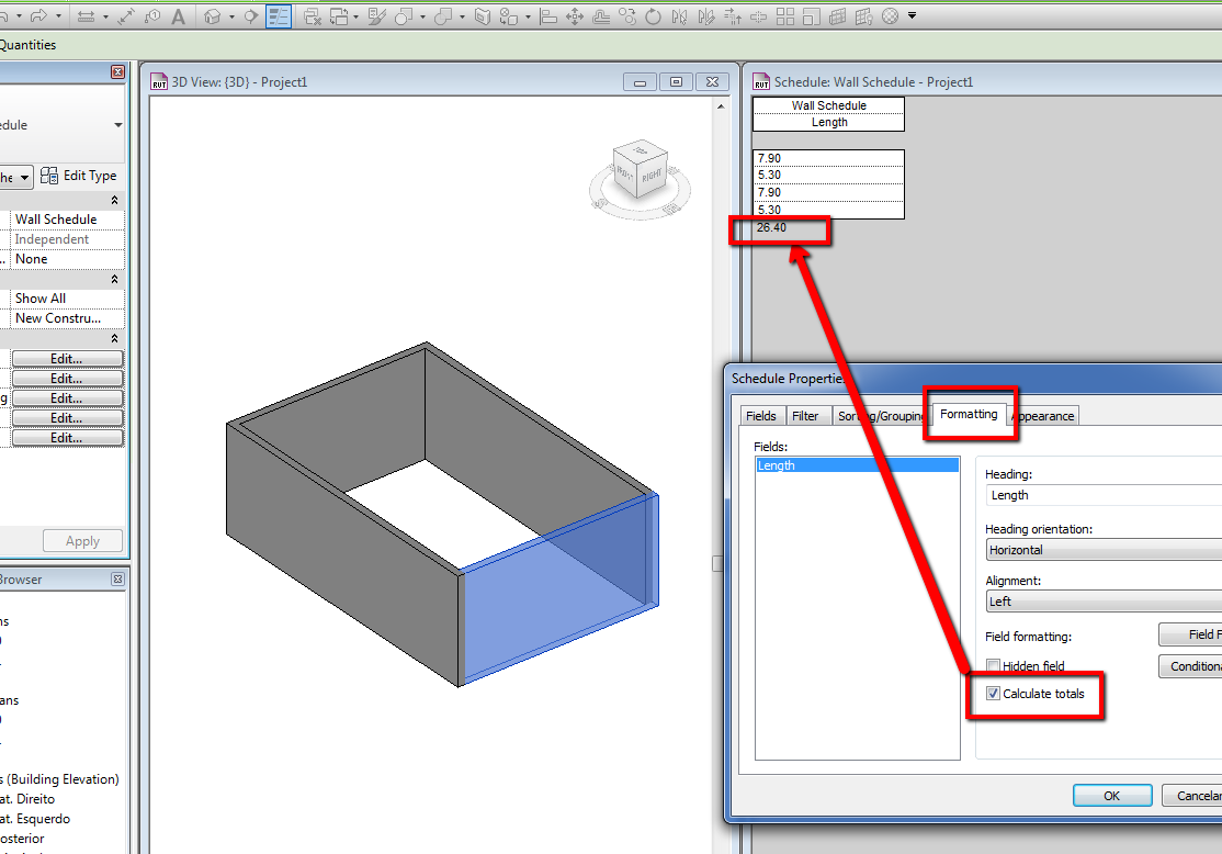

I created a wall schedule to also find out the total length of base I need, only to find that I can not select calculate total
under the length field.  Does anyone have any suggestions?

whoa amazing, thanks, saved us so much time with that screenshot!!!
