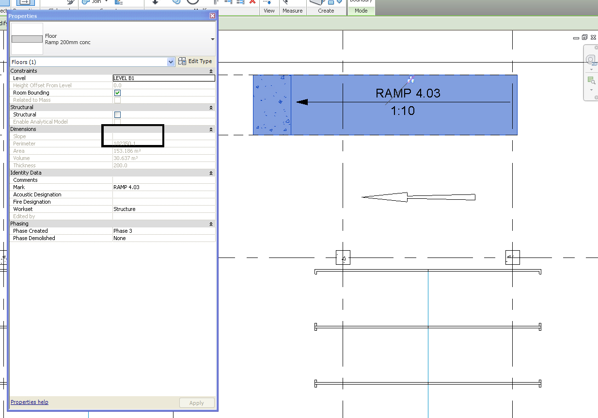

Does anyone know of a way to schedule the slope/gradient of a ramp or floor?
If I create a ramp or floor schedule, slope isn't an available parameter. And under the properties of the floor, 'slope' is greyed out and left blank even through it is a slope. If you can annotate it with a spot slope (1:10) surely you can schedule it?!
Suggestions?

Instead of using a slope arrow, this slope is defined my using one edge of the floor and assigning a slope like you would on a roof.  Even when used, this field is still not available to schedule.  You could add a project parameter to floors that you could fill out and it would schedule.

Thanks but the project paramter would be a manual entry no? If the gradient was to change I'ld have to go and manually update all of them???

Yes, you would have to manually update them.
