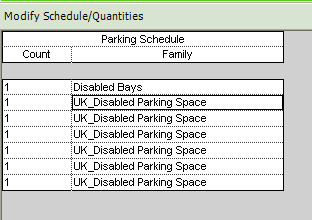

Does anyone know how to create a parking family with nested parking families that can be scheduled correctly?
If I use Revit's out-of-the-box 6-bay parking family It actually gives me 7 bays as it counts the family which hosts the bays as a family!
Thanks

I don't see this family in the 2012 library, where did you get it?
I didn't open it but if the host family is not a stall too, then the family is built incorrectly.

It was from revit 2012 (UK) library. The host family is a stall so it should work. Any suggestion? Do you have one that does work?
