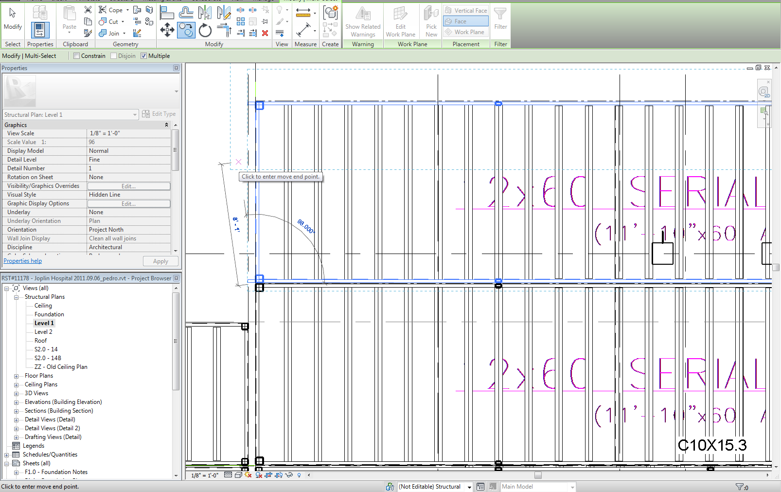

I have these 4 girders under the columns above them. As far as I know there's no attachment to the columns. There's a beam system between the four girders. When I copy the girders, columns & beam systems anywhere, the girders overextend themselves as shown in the screenshot. How can I better control this?

I guess, my best guess, is that the analytical lines are not catching.  You might try adjusting the lateral justification if the geometry works out.
or
The start/end extension of the beams has a value.

how can I keep the start & end extensions from creating values on their own?  They seem to be created automatically as I copy/place/move beams.
