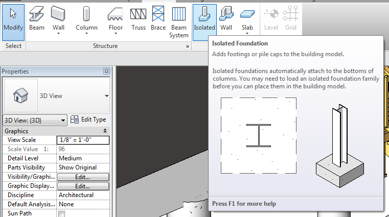

Can you just used the 'isolated foundation' function after placing the column?
