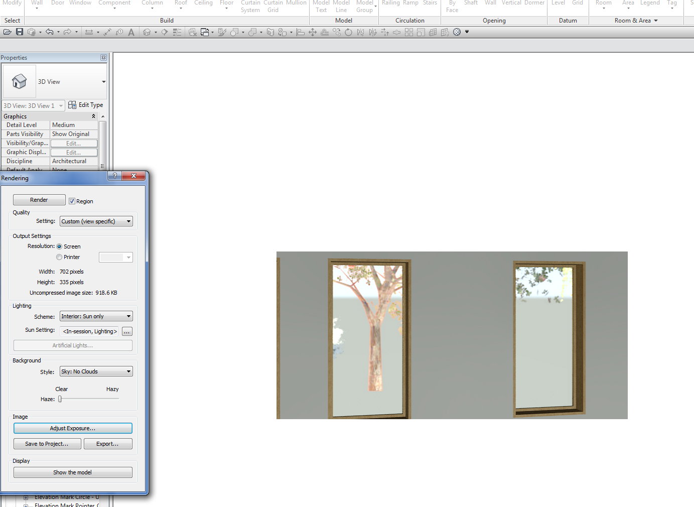

I have some RPC trees in an internal atrium space.  When I render the internal view, the trees don't show up.  I've tried all the various lighting settings, restarting, reinserting the trees, etc.
The trees work well when inserted into a new project with a simple toposurface, but when I link this into my main file and run a render, they disappear again.  I'm running Revit 2012.  Any ideas?

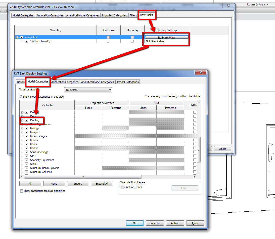

I did a test and no problem, do you have the "Planting" turned ON in that view?

Hi,
Yes the planting was turned on, and I had tried all the different lighting settings.  I have solved it now by setting up a new camera view.  The first one was set up in Revit 2011 and could be an issue with the upgrade to 2012.
