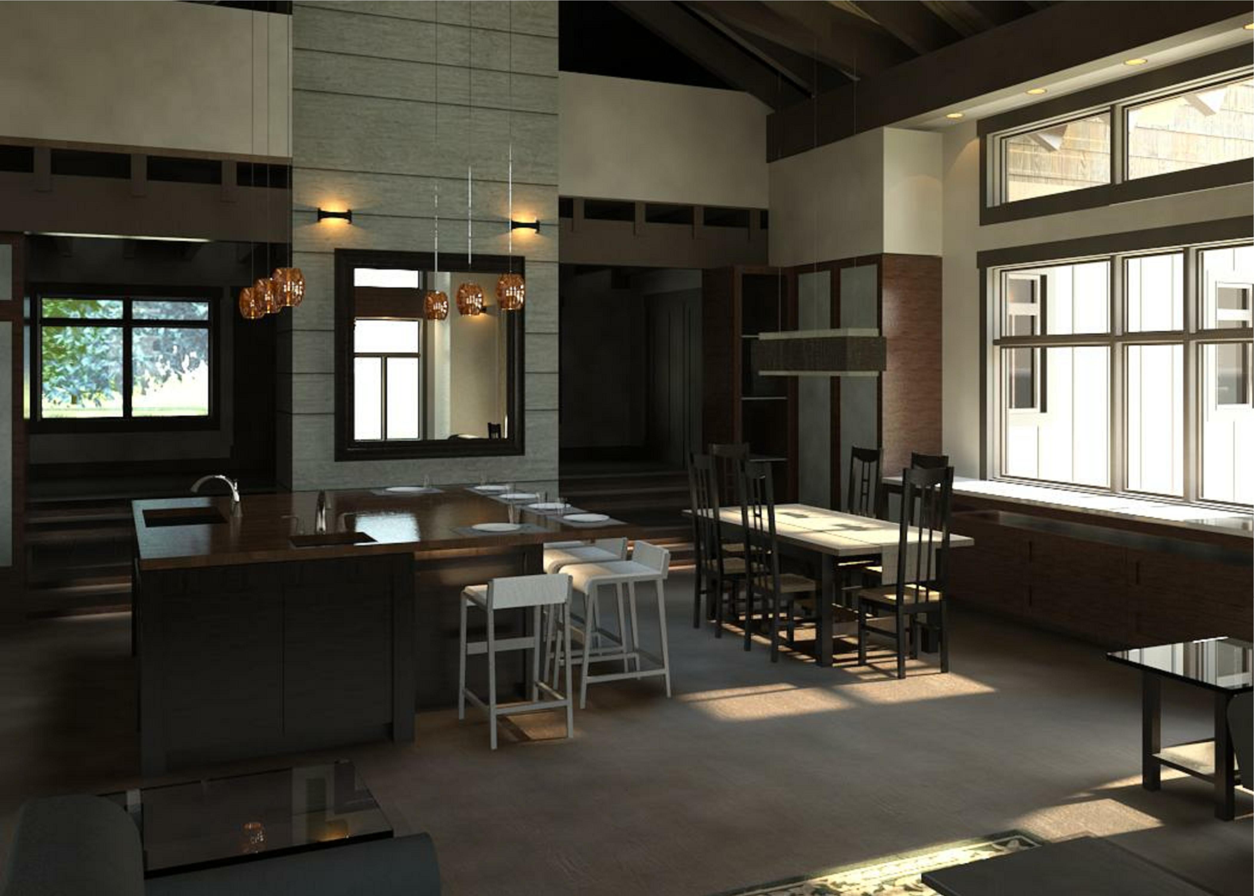

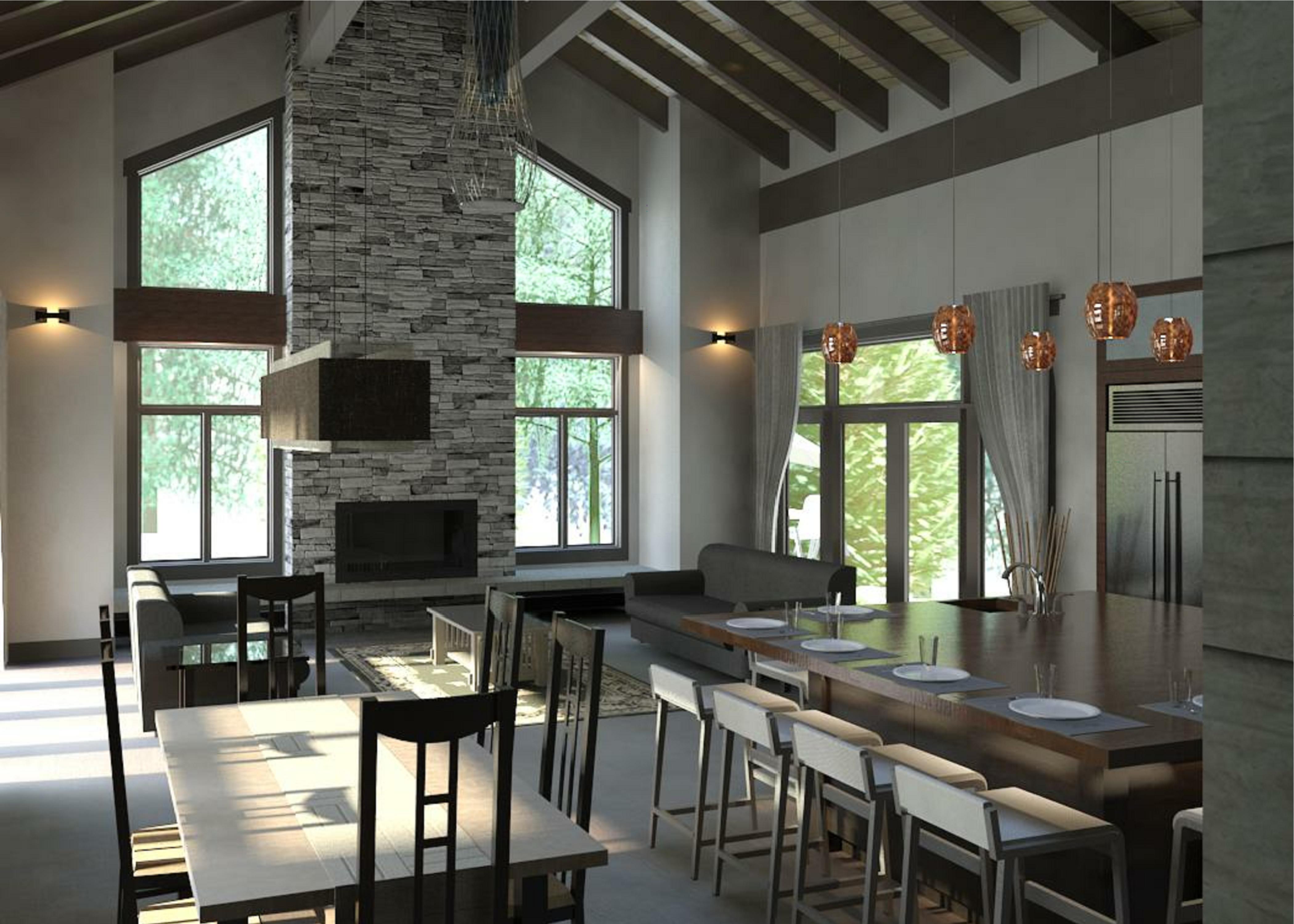

Hi, I am trying to do renderings in revit that will allow me to use them in virtual tour software like easypano.
Example: http://www.easypano.com/gallery/tourweaver600/realestate/tour.html
The idea is to create renderings of the four interior walls of a room, the ceiling and the floor. The problem is that the camera should be in EXACTLY the same place, or to be more specific, the lens, should rotate around the same point.
Does anybody have any experience in this? I know Max had this built in in 2002, but havent seen it lately.
Any thoughts would be appreciated.
Renderings done in Revit, no addional work afterwords. 96hours/image.

firstly, your renderings look awesome!
Insert your camera, position where you want it. in your 3d view project browser area, right click on the 3D view just created and duplicate it. Go back to your floorplan, right click on the name of your 3d view you just duplicated in the project browser, and click "show camera". Then grab the pink dot and rotate the camera around.
Repeat.Hope you understand.
