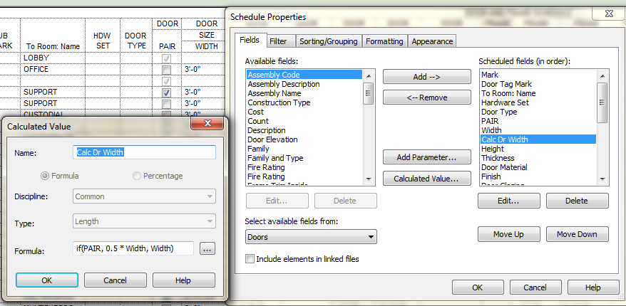

We do it a little different than James.  We have a yes no switch for double or not.  That ends up showing as a check in the schedule.  Then we hide the door width column and have a calculated filed titled width that is conditional.  It calculates the door width as whole or half.  This works well for all conditions including storefront doors but it will not work on unequal leaf doors.  We usually don't have those.

WWHub could you expand on how you do that?  Is it set within the parameters or is it a text box in the schedule.  I am desprately trying to figure out the best way to do this on a large project.  The doors I have in the project are the standard ones from the Revit library.

Tue, Jun 25, 2013 at 11:53:44 AM | Manipulating the door schedule
A single, 3' door schedules as a 3' door with pair NO.
A pair of 3' doors schedules as 3' door with pair YES.
See attached

Tue, Jun 25, 2013 at 2:51:57 PM | Manipulating the door schedule
CDWdavid,
You can always create a manual parameter (text) and fill it in manually.  The process we were talking about is a truely parametric schedule.
