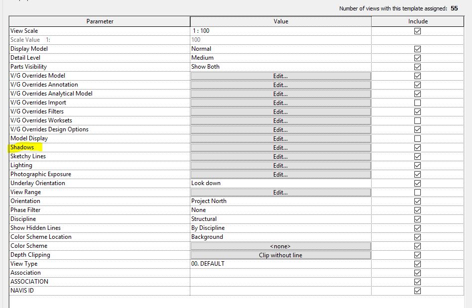

Within Revit 2019 shadows are controled within the View Template assigned to the view.

Actually, they are controlled by the Graphic Display Options.  These can be assigned to a view template (or not).
