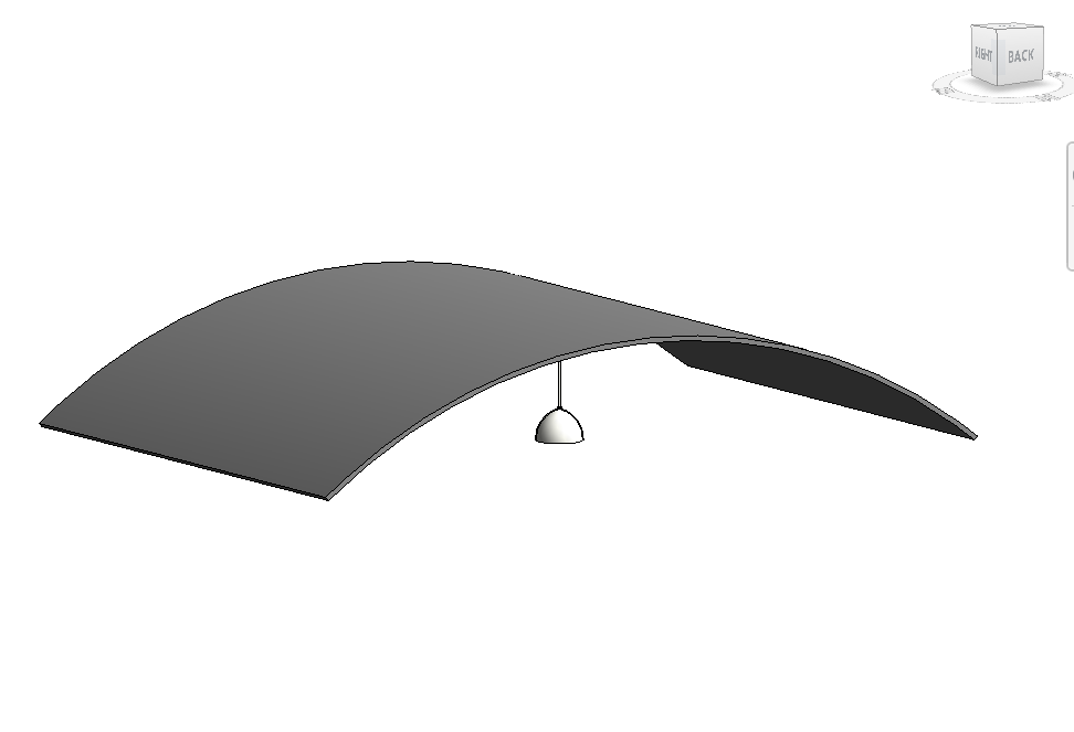

In one of my projects the roof is of irregular shape and is like an arch.Lights are not hosted directly on the roof, so I need to create a celing which is not flat/horizontal but curved in section(concave) like an arch.
How can I create that kind of a ceiling?In place Mass?How to make that mass behave like a ceiling so that it will host lights?What is the exact command?
Actually I don't need a ceiling but want it only so that lights can be hosted.

Create that with "In-Place" in "Ceiling" category.

Thanks...it worked...
Curved Celing
