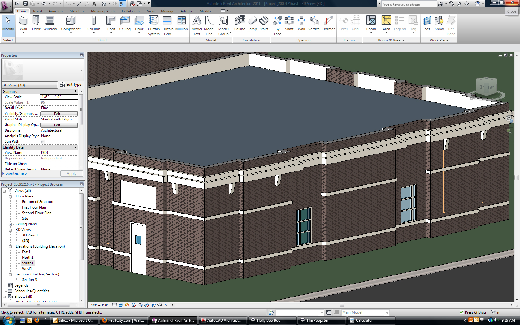

Thanks so much!  The face based generic model worked.  It doesn't work with all the choices I've made up to this point, but for anyone else, it would probably be perfect.  The face of the void stops at the outside face of the wall, which is also where my GFRC band begins.  Even though it doesn't actually intersect with the GFRC band in the middle of the wall (A sweep I added to the structure of the wall type) it breaks the line.  Not what I wanted.  Sad  (Image 1)  But I know could always remove the sweep from the wall type and just make the sweep a generic model component.

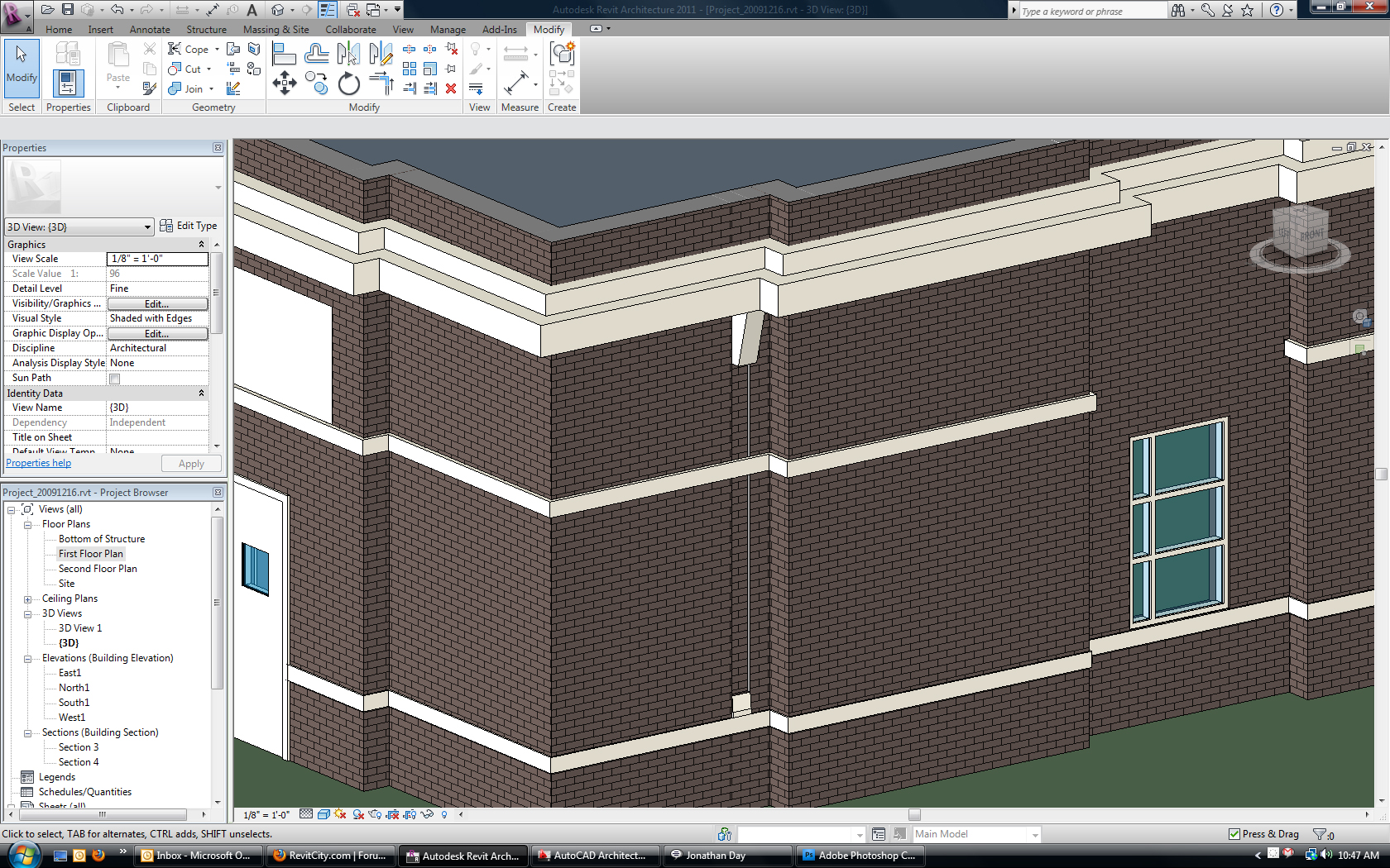

In case anyone else has the same issue, I chose an entirely different approach.  I created a separate wall type with the recess added in the structure of the wall.  So a 4'-8" segment of wall with the 8" recess is actually 2' of Wall Type 1 (no recess), 8" Wall Type 2 (with recess) and 2' of Wall Type 1 again.  (Image 2)  That way it also keeps my brick as my exterior material and I don't have to go paint each recess.
