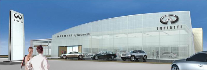

Hi guys, I am still kind of a novice in revit (using revit arch. 2011) and i am trying to model this curtain wall for a project. I have attached a sample image of it. The wall is curved in plan and has this curved & slanted profile in elevation. Can anyone pls. help me model this in revit. A little detailed explanation is appreciated as I am still getting around the software. Thanx a lot

Because the wall is "curved in plan" you can't "Edit Profile", so, you need to create a "MASS" with that shape, then apply "curtain wall by face".

This looks like the only thing curved is the top and possibly the ends.  You don't need a mass, just place a curtain wall then edit the profile.
