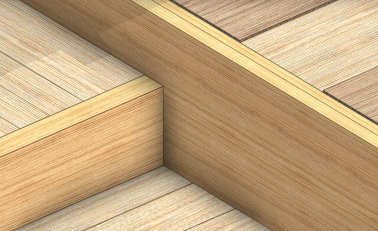

I'd take a picture of what you want, yes.  My most successful render materials have been created with a scanner or camera, and photoshop.  Getting the edges to line up is extremely easy if you *cut* the pattern mid tile, *paste* and *flip horizontal* on the opposite side of the image.  You'll see virtually no repetition in the pattern.
Here's out wood texture for cedar that we use heavilly.
We put a shingle on the scanner.  No kidding.  Looks better than every single wood texture included with revit, and is similar in size - 500kb.

itsmyalterego....that wood texture is really really good. Also you are correct when creating your own material in photoshop or whatever it is, the quality seems to be alot higher.  I just can't believe this tile issue is not standard in revit, I guess you can't always get what you want.  Anyways back to the typical photoshop to create my tile. I will upload my rendering when its done to show how it came out. Thanks for the help guys
